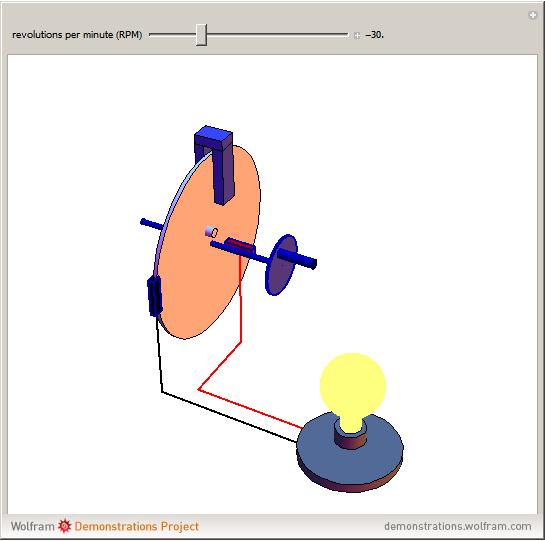

disk and magnet spin together -> induced currentI ask can anyone properly explain why there is induced current in the setup?
lorentz force pushes electrons in the wires
Why, how? To properly explain it is not sufficient to just say Lorentz force did it. There is always Lorentz force between the magnet's magnetic field and electron's magnetic fields in the conducting disk. But to actually strip atoms of their electrons in the disk and move them to the rim or the center, this Lorentz force must therefore be somehow different, or stronger, than when both the magnet and the disk are stationary. Proper explanation must address how and why Lorentz force changes the way it does for each particular setup.I did not find any other paper or article says that, when both the magnet and the disk are spinning together, current is actually induced in external circuit and not the disk.
This thread is reopened with some editing to focus the topic, the OP will post some further clarification.
Note, the scenario in the previously linked Wikipedia page references a uniform magnetic field and an axisymmetric magnet so the analysis is not applicable and references to it were removed.
Ok, let's first describe the depicted setup. You should always label such figures properly. So I can only guess by (my personal ;-)) common sense, what's depicted. The horse-shoe shaped thing is the magnet, and the disk is a conductor. The voltage ("measured" by the light bulb) is between a point at the center of the disk to its rim.
I cannot explain this quantitatively, because I'm not aware of a full expression for the magnetic field of the horse-shoe magnet. But qualitatively it's easy to discuss the three setups, that where described originally. Let's start with the one left in the edited thread:
(a) Magnet and disk are rotating together (i.e., the magnet is fixed on the disk). There is a time-dependent magnetic field, giving rise to a electric field and thus a Lorentz force [itex]\vec{F}=-e(\vec{E}+\vec{v} \times \vec{B}/c)[/itex] is acting on each electron in the disk. Here you can assume [itex]\vec{v}=\vec{\omega}\times \vec{x}[/itex] for the velocity of the electrons, because the velocity according to the drift due to conductivity can be neglected for such usual household setups. So there will be a current flowing through the light bulb. If it's large enougth, the light bulb will be "on".
(b) Only the disk is rotating and the magnet is fixed. Then the magnetic field is stationary and no electric field is induced by it. Nevertheless there is a (now purely magnetic) Lorentz force acting on each electron in the rim [itex]\vec{F}=-e \vec{v} \times \vec{B}/c[/itex]. This leads to a drift of charges and the buildup of a charge density at the rim of the disk. Thus you have a voltage between the center and the ring of the disk, giving rise to a current through the light bulb, which is shining again, if this current is large enough.
(c) Only the magnet is rotating around the disk. Again an electric field is induced due to the time varying magnetic field, and the same qualitative explanation as under (a) applies.
I hope that settles the issue. There is no paradox. It is only important that such setups are to be solved by using the complete Maxwell+mechanical (relativistic!) laws, including the Lorentz force on the conduction electrons in the metallic pieces of the setup. There is also no contradiction with Faraday's Law in integral form, which has to be written in its complete form, including the time variation of the surface boundary due to its motion if such a surface is used to calculate the flux.

I stumbled across this thread and would like to offer what I think is a simple explanation to the original poster's question.
"I ask can anyone properly explain why there is induced current in the setup?"If the magnet and the disk are attached and rotate together and I am sitting on the magnet, what do I see? I see flux lines extending up from my feet.
If the magnet and disk are rotating and I look over my head, what do I see? I see wires connecting the load cutting these flux lines, once per revolution.
The voltage is generated in the wires connected to the load! If no load were connected there would be no voltage generated.
Now let's make the magnet and disk remain stationary in the room and put the load on a platform which may be rotated about the disk. When the load is rotated about the disk there will be a voltage generated in the load even though the magnet and disk are stationary relative to the room as a frame of reference.
I've never understood why this is a paradox when both types of Faraday machine are similar depending on the frame of reference from which they are viewed.
There is one difference.
In the conventional Homopolar machine with the magnet stationary and the disk rotating, there will be eddy currents generated in the disk.
With the Faraday Homopolar machine, there are no eddy currents in the disk.
