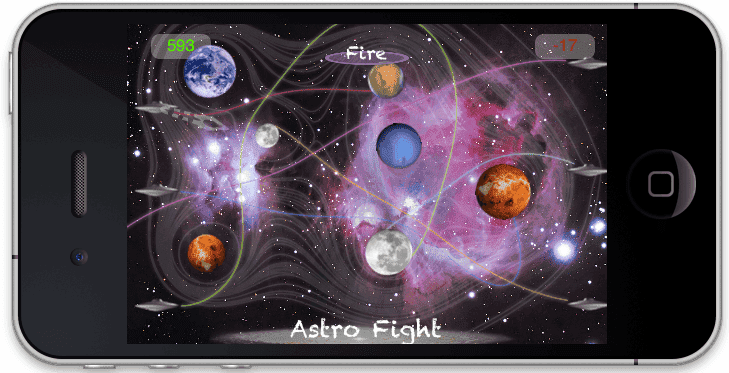

I have to find a fast way to compute changes in the level lines as the result of sudden changes in the local gravitational fields (2D space). (Caused by the destruction of a planet for example). I could recalculate everything but it takes too much time for the device on which the calculation is deployed. The environment has lots of bodies, so an analytical solution is not to consider.
I compute the level lines, picking a initial point and iterating along the gradient of the potential field.
I don't really know where to start, but I'm thinking about a local method that only propagates changes on a limited range around the "explosion". If you want to take a look of the origin of the problem, here is a screenshot of the project, and the link to the related iphone game.

Sorry I mixed up the terminology. What I called level lines is equipotential lines, i draw them by following the direction orthogonal to the local gravitational force. (Sorry for the confusion)
That works well (check the pictures, the grey lines in the background) but takes some time ! I don't use any graphic library. So I guess my question is : once I have the contour plot, and when a planet explods (I assume that planet fragments just fly off the screen so the mass disappears), I need to redraw part of it without freezing the animation. I tried to only redraw a small part of it (considering that the gravitationnal influence fades away quadratically but then my lines are obviously not continuous anymore...
The grey lines in the pic look like trajectories ... but you have described equipotential lines all right.

Switch off the gravity at a spot will create a discontinuity that travels outwards at the speed of light. If you accelerate a field source, you get a wave associated with the field ... creates a jagged bit in the field lines. It may be a sensible way to do it on the scale of the pics ... use a rapidly expanding circle around the original location of the planet.
What you want is just t switch from one set of lines to another ... what are the lines used for?
If it is just for display - to make it look cool - then you can just animate the redrawing to work in with what the machine is capable of.
Thanks for the answer man, the expanding circle is a great idea ! And yes it's really only to make it look cool. And i don't think there are libraries for iphone that draw level sets of an arbitrary function... I'll try to use an animation and compute the new lines in a different thread to not freeze the game on the iphone.
