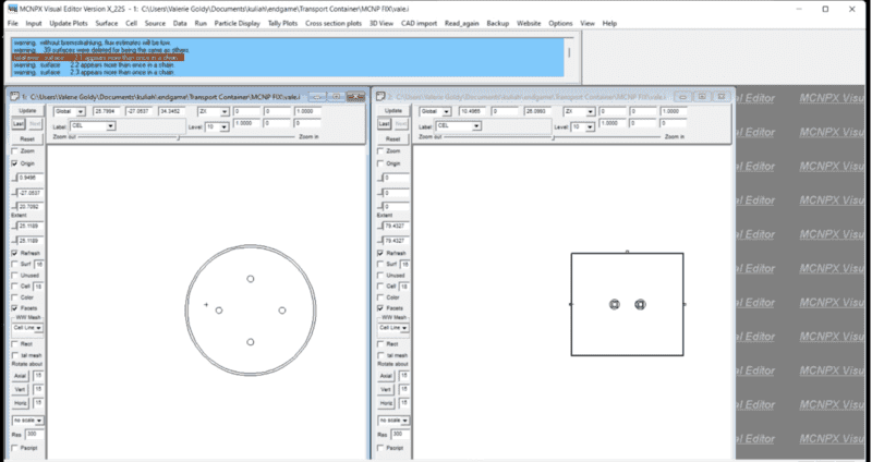

Hi, can anyone help me? I am running the code for the container for the radioactive waste. I run on Vised, but suddenly it can't run due to a fatal error. I also have attached the error. Kindly hit me up if you can help to solve this issue. Thank you!

Your image is not high enough resolution to read the error. Can you upload a zoomed-in picture of the output lines in the upper left?

It says:
Warning without Bremsstrahlung flux estimates will be low
Warning 39 surfaces were deleted as being the same as others
Fatal Error surface 2.1 appears more than once in a chain
Fatal Error surface 2.2 appears more than once in a chain
Fatal Error surface 2.3 appears more than once in a chain
I suppose repeated 39 times

The error looks like it's normally caused by the use of fills where a surface appears at more than one level, say defining a fill and also in the cell description of the fill universe.
The VisEd errors will match the output file, but the output file should have more of an explanation; which offending cells that surface is in and where they are in the chain. The offending surface 2 is composite which is why we have decimals. Fills are normally done into a bigger volume and the filled cell acts as a cookie cutter, filling with the same size would produce this because edges would be coincident. It's normally a warning. I have no idea why this is a fatal error.
Just as an aside, VisEd X_ 22S corresponds to X 2.6 - circa 2008.
If we get more info, maybe we can help solve this. If the OP has solved this, I would hope we're told.
