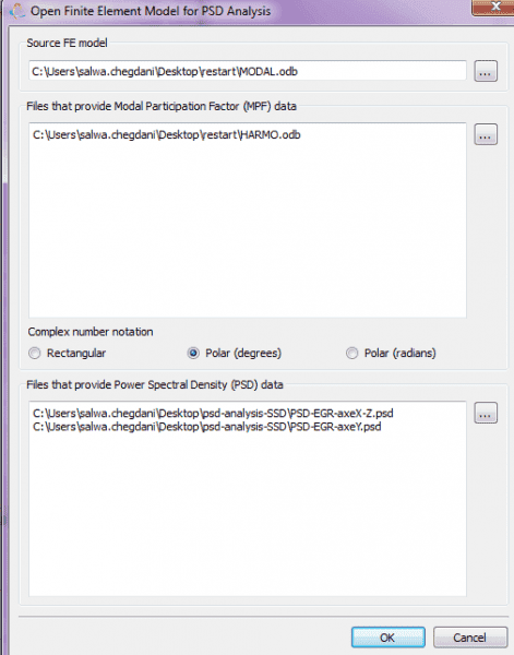

I started working in Harmonic analysis using Fe-Safe. my FE model (abaqus) contains 4 steps :
  1. the first contains modal step to compute the natural frequencies
  2. the 2,3,4 step; it is a steady state dynamics steps (harmonic)
From Fe-Safe Documentation, to perfom a fatigue analysis for Harmonic and PSD analysis, we use PSD analysis, and fot that you need 3 files:
.odb file with natural frequencies
.odb file with Modal Participation factors
.psd the PSD matrix.
so i run firstly the modal step,then afte, I make a restart to compute the steady state dynamics response from the modal results. to obtain two files .odb
-Modal.odb : Natural frequencies
-Harmo.odb=GU: Generalized displacements and GPU Phase angle of generalized displacements for all modes.
Please, can you help me to create the second file .odb which contains only the Modal participation factors (GU, GPU)?
Thanks in advance.
Salwa.

Hello,
I have the exact same problem. I also dont't know how to make Steady State Analysis correctly for import for fe-safe PSD Fatigue analysis. When I try to open all required files, I always get ".odb has an invalid extension (it should be mcf)" Have you made any progress since? If you have, could you please tell me how to create second odb. file?
Thanks in advance.

Looking at the help manual for fe-safe 6.15-02, two .odb files are required.
1. Modal stresses need to be calculated using a natural frequency extraction analysis. The Abaqus specific modal participation factors should be created.
2. Once 1 is complete you need to run a steady state dynamic analysis to generate a set of displacement related results.
The manual warns to be sure that modal participation factor for each node are matched to steps in Abaqus, plus the frequency interval for which output is requested for each step is identical.
...talking to someone more familiar with the PSD analysis, it sounds like Nesho and salwacheg are both in situations where they are using Abaqus (odb) but fe-safe is expecting ANSYS. You need to play around in the PSD Open Model Dialog to be sure that the filetype is set to "odb".
I had a little breaktrough today... for the second ODB file, you have to make "Steady-State Dynamics, Modal" analysis, and under "History Output Request" you have to add "GU, Generalized Displacements" and "GPU, Phase Angle of generalized displacements". Then fe-safe recognizes second ODB file correctly and and it doesn't show "...odb has an invalid extension (it should be mcf)" anymore.
Thanks for the suggestions anyway
