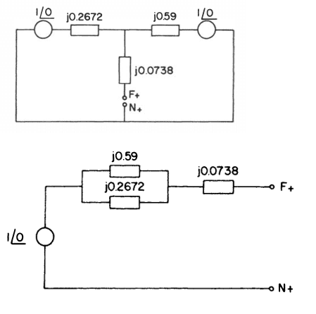

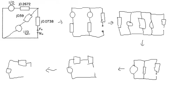

All voltages and impedances are in per unit values.
After all the source transformations, why is the voltage source still 1 ?
Please attach your working.edsoneicc said:I actually tried solving it and I got V=-17.146 with zero angle
