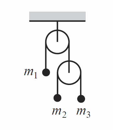

Hello. I'm wondering why my approach to solving this problem (Morin 3.2) is faulty.
A double Atwood's machine is shown, with masses ##m_1##, ##m_2##, and ##m_3##. Find the accelerations of the masses.
##F = ma##
Let's say the string over the bottom pulley has tension ##T## and the string over the top pulley has tension ##T_2##. Assuming that the pulleys and ropes are massless and defining the upwards direction as positive, I have several equations:
(1) For ##m_1##: ##T_2 - m_1g = m_1a_1##
(2) For ##m_2##: ##T - m_2g = m_2a_2##
(3) For ##m_3##: ##T - m_3g = m_3a_3##
(4) For the lower pulley: ##T_2 - 2T = 0##
(5) From conservation of string: ##a_2 = -a_3##
If I substitute ##-a_3## into (2) and then solve (2) and (3) for ##T##, I find ##T = \frac{2m_2m_3g}{m_2 + m_3}##. From (4), ##T_2## is twice this value.
Then, I substitute my expression for ##T_2## into (1) and solve for ##a_1##, which yields:
[tex]a_1 = g\frac{4m_2m_3 - m_1(m_2 + m_3)}{m_1(m_2 + m_3)}[/tex]
This answer is close to what Morin writes, but is missing a term in the denominator. After reading his solution, which uses the fact that ##a_1 = -\left(\frac{a_2 + a_3}{2}\right)##, I feel that I can understand why his approach works. However, I do not see where I made a mistake.

This is where you have made a mistake . Why ?
Conservation of string can be looked at in two ways .
Since you use all accelerations in one direction , this would be an easier way to understand -
Total power by string must be zero ( Why ? ) . Power = F.v , so total sum of of each individual power provided by string must be equal to zero .
So 2T*v1 + T*v2 + T*v3 = 0 , or ,
2v1 + v2 + v3 = 0 .
So what relation do you get for acceleration ?
I hope this helps .
Oh, right. I just realized that ##a_2 = -a_3## only holds in the reference frame of the pulley, not the ground. Don't know why that point eluded me for so long. Thanks.

Your error is with the equation you get from the "conservation of string", as Qwertywerty points out.
A simple way to see that this is erroneous is: Suppose that m2 = m3 . Then we must have a2 = a3 , but these won't be zero in general.
