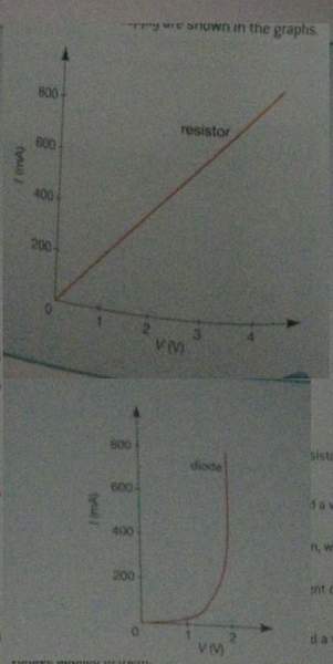

Hi,
Hoping someone will be able to help me out with a electricity homework question that sounds a bit unreasonable to me.
Question 8 (Read the section after Q4 first!)
The I-V characteristics of a diode and a resistor to be used in a simple circuit with a varaible voltage power supply are shown in the graphs.
I have a linear graph for the resistor for which I = 200mA at V = 1 V
I have a graph for the diode for which I = 0 mA at V = 0, I = 20 mA at V = 1, I about 1000mA at V = 2 ... At V = 1.8, the graph is near-vertical.
The question:
The diode and resistor are placed in parallel and a variable voltage applied to them.
a. If a voltage of 4.0 V is applied to the combination, what current will flow through them both?
Ohm's law, V=IR. Applicable always to Ohmic devices, and applicable to non-Ohmic devices only for constant V or I (R is always changing).
If I extrapolate the graph of the I-V characteristic for the diode to V=4, the gradient approaches infinity. Thus the resistance of the diode approaches zero. (R = 1/gradient). Since V = IR, the voltage drop across the diode also approaches zero.
Therefore the effective resistance of the diode-resistor series pair is equal to the resistance of the resistor, 5 ohm.
At 4.0V, I = V/R = 4V/5Ohm = 0.8A = 800mA.
However, the answer states 400mA.
I have attached a photo of the page with the graphs.
If my working is wrong, I would really like to know where I went wrong!
Thanks!
Stephen
Correct so far.
Not correct.
Not correct.
The resister and diode are in parallel.
You described a situation where the diode is conducting - therefore it can be replaced by a short circuit.
Is the connection parallel or series?

The question asks:
That implies it's in series. If in parallel, it should say through "the combination", or somesuch.
Sorry... it was a typo. The diode and resistor are in series, not parallel.

The total drop across the pair is 4V, but you do not know how that is distributed.
Can you think of a way of superimposing the two graphs to represent this?
Likes 1 person
Well, in series, the current is constant across the circuit. So if I can find V for which both graphs have the same I, I guess that would be it... something to chew on... looks like I = 400mA for which both V are approximately equal to 2V!

Yes, that looks about right. But I ask again, can you think of a way of superimposing the graphs that would allow you to read the answer straight off?
