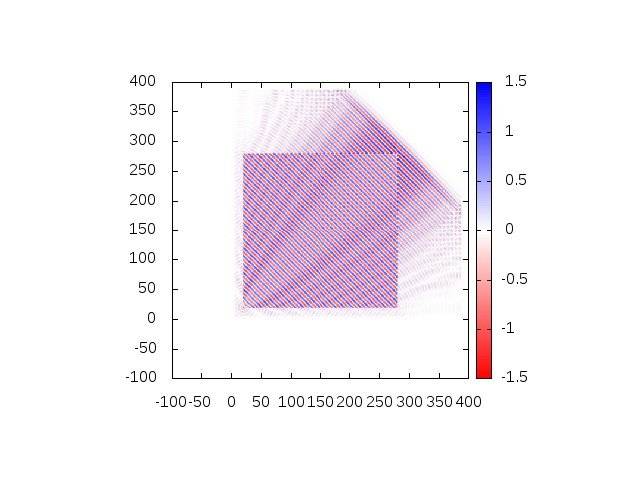

hi all...
I have written codes for 2d fdtd tfsf with berenger's pml absorbing boundary. But I have serious leakage at front and right boundary. At the first place I think the problem is because the pml, but pml is working perfectly in the left and bottom boundary. I need an advice whether the problem is coming from tfsf boundary or absorbing boundary condition. Attached here is my code as well as output produced.
Code:

Not understanding what you're trying to do but trying to help.
Often when a program mostly works but has some problem on the fringes of data computation means that perhaps your for loop indexes are off by 1 so say you want to loop ten times because you have ten values to average but an index is off by one then you actually loop by 9 or by 11 times meaning either one number was not averaged in or some undefined number was averaged in causing strange artifacts in your data as you used the average to compute over things.
So the bottom line is check your loops to be sure they are iterating over your data correctly.
You have some weird code:
Code:
 imp = sqrt(miu0/eps0)
 smax = -3.0*eps0*c*log(1e-5)/(2.0*dx*npml)
 rmax = smax*(imp**2)
Why not the following:
Code:
 rmax = smax*(miu0/eps0)
Taking square roots and later squaring the result for re-use kills some of the precision of the original value.
Steamking,
I have changed the weird part, but the output is still same.
sorry...I expected anyone who know FDTD are familiar with term tfsf and berenger's pml because you can find it in fdtd textbook everywhere. Sorry, I will more concern about this. Thank you for your advise.
FDTD : finite difference time domain
TFSf : total field scattered field
PML : perfectly matched layer
I see lots of fishy stuff, which may make problems. In defining double precision constants, why do you use "e" instead of "d"? Pi is a double precision number, but you only assign it to 3.14159. Hence, cosphi and sinphi should both be equal to sqrt(2.0d0)/2.0d0. Are they?
Always write e.g. "1.0d0" instead of "1.0", only.
I am newbie in Fortran. I may mislook about these things. I noted that pi should be assigned as pi = 3.14159265358979. for double precision constant, as example c = 3e8 means that c = light velocity = 3x10**8. about cosphi and sinphi, I don't understand why did you suggested that?
I mean you should write c=3.0d8 instead of 3e8. d is for double precision numbers, e for single precision.
This cosphi and sinphi are used very often and imprecisions in pi may matter.
