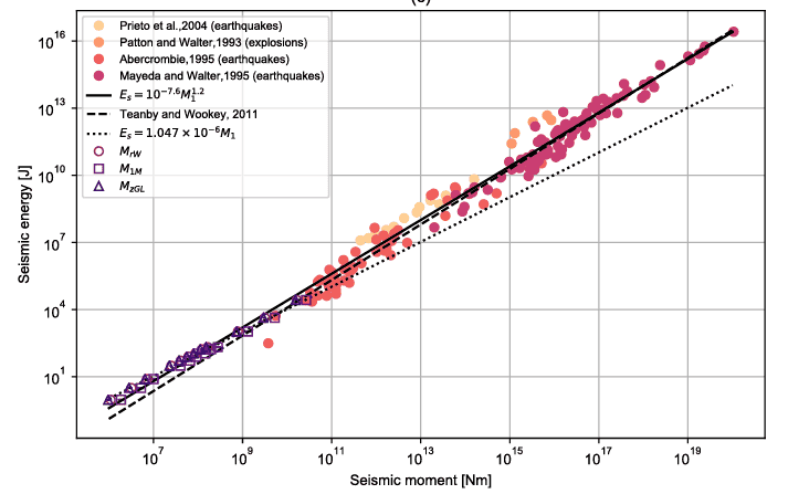

This paper suggested that smaller events are harder to detect than expected, only impactors with >10m craters formed within 400km of InSight offer the most promising chance of detection (this corresponds to an event with seismic energy=25,000J). That paper also showed that an explosion can convert half of the seismic energy into the seismic moment (0.27, edit: this is a modifier, not the overall efficiency) compared to that of earthquakes (0.54) and their relation is log-linear. But it's still more efficient than impactors (~0.1).
(edit: this also means a nuclear explosive device is more effective than a nuclear-powered rocket impactor, be it an NTR or ionic)
The difficulties in picking up small seismic events also lead to seismic data biased towards major and close events (close to rovers.)

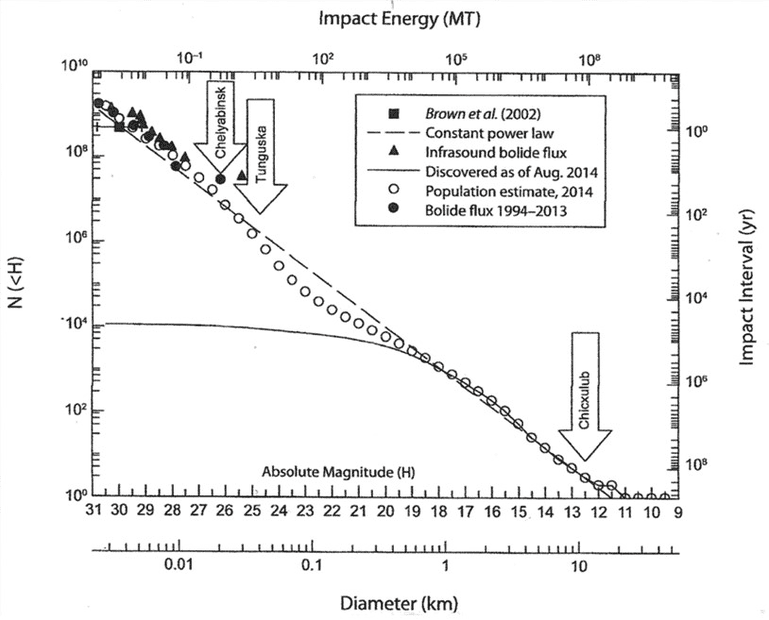

See the figure from Asteroids IV, note that asteroids of the same size have different energy when impacting Earth and Mars, the most common asteroid type is near-Mars objects and near-Earth objects, tend to impact planets at their escape velocity. This gives the same Mars asteroid 5 times the energy when it hits the Earth. Thus, in events similar to the 63GJ (these figures are known as seismic energy, not directly applicable in the figure above, the asteroid itself has a size of 12–37 m, let's say 20), we can estimate the weight of the asteroid to be 14K-ish tons based on density data of the Mars impactor (14K ton at 5km/s is 63GJ, I'm assuming 100% kinetic to seismic efficiency just to show how rare big impactors are). This would be a 0.18MT event on Earth, occurring around once half a century on Earth, and once a decade on Mars. Once a decade for an unpredictable Mag 4 marsquake is already not very satisfying, and the way we calculate only means the real probability is much lower.

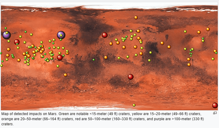

Back to the science yield question. Marsquake is by far our only way to study Mars' deep structure. A larger impact could help with the study of the molten layer within Mars' core, whose discovery is only made possible by the 63GJ event. This grants insights into the core's dimensions and composition, how Mars formed, evolved and became the barren planet it is today.
One of the challenges with relying on natural impactors is the uncertainty (you can see impacts on the impact list with uncertainties going way up to decades) and delay in their detection and characterization. Many impactors are only confirmed after visual identification, which often occurs too late for optimal scientific study, especially for thermal science. By the time an impactor is located and sensors are deployed, the immediate thermal effects have dissipated, making it difficult to study the heat flow resulting from the impact.
In contrast, a controlled nuclear detonation offers a predictable and immediate source of seismic activity. Such an event is also a strong magnetic event, which will aid in magnetic study, particularly on how its metal core reacts to the magnetic event. Plus if we consider the future of Mars exploration and potential colonization, understanding and possibly revitalizing its magnetic field require very detailed information on its deep structural insights, but that might be too Musk.

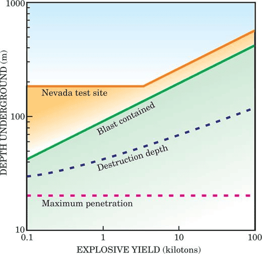

Also here's a picture showing the depth required to contain a nuke.
The figure is for earth (and earth's gravity). Mars has a lower surface gravity, so one would have to bore deeper - more than double, and perhaps triple.
The average gravitational acceleration on Mars is 3.72076 m/s2 (about 38% of the gravity of Earth) and it varies.
https://en.wikipedia.org/wiki/Gravity_of_Mars
Note in the figure, the scale only goes to 100 kt.

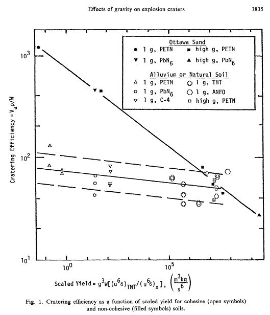

I've just found a paper for this, the crater diameter for the same explosive charge D is proportional to g-1/6, which means a Martian crater is likely to be 1.176 times as big as an Earth one. According to the paper, its conclusion holds for buried and zero-depth charges, as well as the cohesionless soil of Mars. The soil used in the paper has a similar density to Martian soil. On page 3839 in 4.3 it mentioned the condition for a charge to crater. The optimal depth to crater is the critical depth dc, calculated using dc=C0/ρg, where C0is the cohesion (100-1000 Pa for Martian regolith, Chang et al.), ρ is density (1.37 as mentioned earlier), and g is Martian g, 3.71. The critical depth would vary between 20 m and 200 m. It is achievable with the current ground penetrators on the soft Martian sand but this doesn't say anything about the choice of yield.
Crater efficiency is discussed on page 3835 but I haven't found numbers for nuclear bombs yet. But if we assume a nuclear bomb is somewhere between the explosives shown in Fig.1 and the sand is Ottawa sand (the most similar to the regolith) we may say the crater efficiency for 1e7 to 1e9 J bomb is around 101.5 or 30. And it can go as low as 15 at 1e11 J. This is a bad sign for nuclear detonation but only in terms of efficiency.
