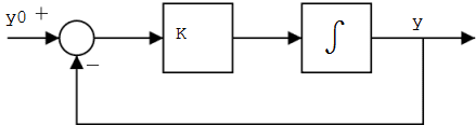

I don't think that's quite right. Remember r(t) gets multiplied by y in the equation specified.
Anyway, perhaps the simplest system would be the differential equation which is associated with Newton's law of cooling.
[itex]y' = -K(y - y_0)[/itex]
The set point would be [itex]y_0[/itex]. When [itex]y_0[/itex] is constant, y will exponentially decay to the set point, y_0.
[itex]y = y_0 + Ce^{-Kt}[/itex]
A block diagram is shown below. Note that this simple system may not work well if you want to hit a moving target (y_0 not constant).
