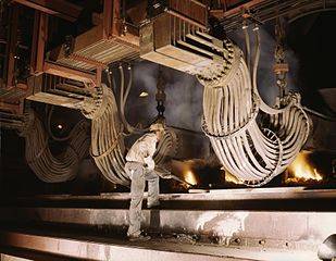

Yes, Most power generation companies provide huge amounts of energy and small fluctuations are moot; compared to smelting operations. Check out these conductors.
