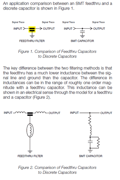

I know the advantages of feedthru cap. But I can't figure out how it works. An equivalent circuit will help.

The Feedthrough cap I was talking about is this one -
http://www.avx.com/docs/Catalogs/w2h-w3h.pdf
I don't understand how to make an equivalent ckt. The grounded pins are like parallel caps to ground and the Signal/Vcc terminals are like a high value cap? That doesn't make sense.

The equivalent circuit is just capacitance to ground. You need to have some series impedance in order to get the lowpass filter (LPF) effect. That series impedance can be parasitic (like the inductance in the DB-9 wires that yungman mentioned), or it can be explicit components like if you used chip ferrite beads in series with the signal connections to the feedthrough caps.
likephysics,
Your google-fu is pretty weak. I got a lot of hits with obvious search strings. This particular example is from this app note:
http://www.avx.com/docs/Catalogs/ftantc.pdf
EDIT: Notice how the inductance is in series with the signal (which is where you want it) for the feed-through cap, while the inductance to ground is very small. This is what gives it its superior high-frequency characteristic. I'm not sure what they mean by circling that inductor, but functionally you can think of the feed-through cap as one without the parallel inductor, i.e. a low-pass T-filter.
