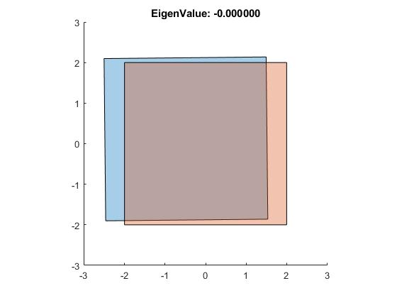

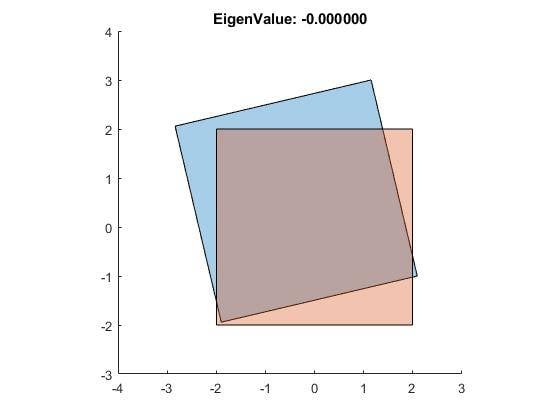

What are the zero-eigenvalue modes of a 4 noded element

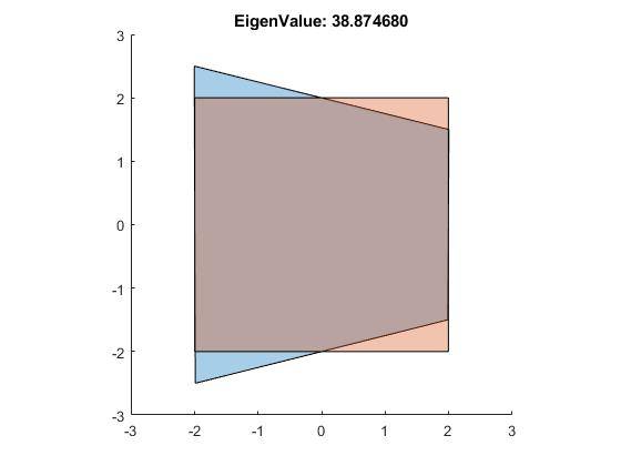

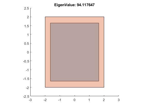

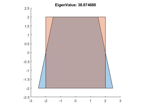

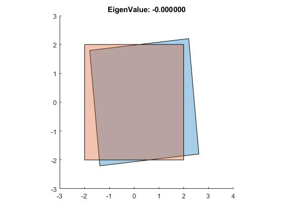

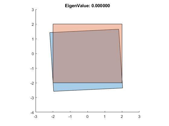

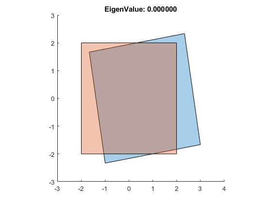

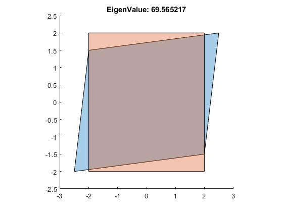

Hello
I wrote a Matlab code to form the 8 by 8 stiffness matrix of a single, 4-noded element, for a plane strain problem for an isotropic element.
I conduct an eigenvalue analysis on this matrix
Matlabe reports 5 non-zero eigenvalue modes, and 3 zero-eigenvalue modes (as expected)
Of the 3 zero-eigenvalue vectors, I KNOW that there should be two pure translations (one in each direction) and one rotation.
(I am doing this because I want to see the hourglass modes, out of interest, but i cannot even get that far to under-integrate, yet)

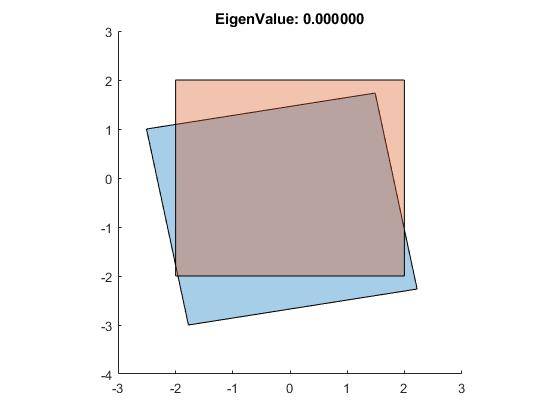

I am doing this in Matlab and I am getting my three zero-eigenvalue "vectors" and they look like this, below (first three images)
I can see that all three manifest free body translation and rotations (some have some deformation, but I can ignore that, for now).
The question is: what can (or should) I do to (in the Matlab code) so that these three zero eigenvalue modes, visualize as two pure translations and one rotation?

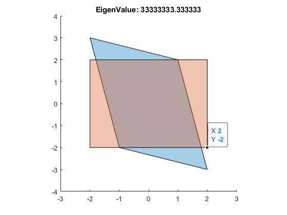

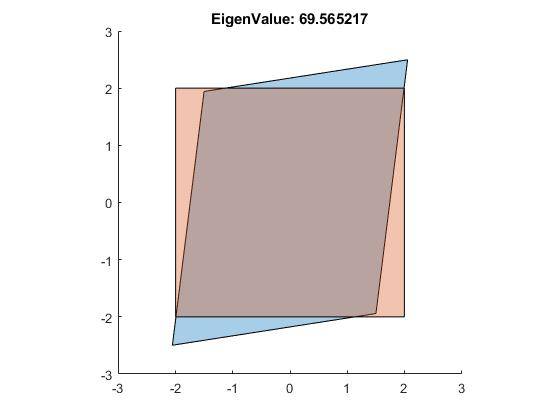

For the hell of it, I also plot TWO of the five non-zero eigenvalue modes (these are all what I expect)
(And to be honest, I would like to remove some of the deformation from the free body modes, too; and the fifth one seems to have pure shear but ALSO a rotation)
It seems as if Matlab is reporting combinations of the eigenvecors (and that makes no sense to me) -- unless I am very confused.

You can check that ##\phi^T M \phi = I##. (if not ##I## then at least a diagonal matrix) If that is true, then the eigenvectors are not a combination of each other.
How do you deal with isoparametricy? (is that a word..? but for quad elements you need an isoparametric formulation)
Also: make these plots with the
[CODE lang="matlab" title="plot"]axis equal[/CODE]
command, such that you get the true shapes of the elements

Can I expand on this?
When the eigenvalues are the same, one can add the associated eigenvectors, and still get an eigenvector: not issue there.
Now in a modal analysis of a quad finite element, there are three zero eigenvalues (you see them, above)
I KNOW that they represent: translation in one direction, translation in a second, and a rotation.
I look at those first three modes above and can almost see the two translations and rotaitons, combined.
My question is this... How can I get Matlab to give me those shapes?
Or, another way, how did they first figure it out? It seems they had to have anticipated, in advance, that there are two translations and a rotation. What is happening in Matlab that is not giving me those, but a combination of them.
Should I have to write a code to actually compute the three eigenvectors by first anticipating the form?
True, but if you combine the eigenvectors, they are not orthogonal anymore and thus ##\phi^T M \phi = I## does not hold anymore (##\phi## the vector with all your DOFs, ##M## the mass matrix, ##I## the identity matrix).
What command do you use? Just the 'eig' command? It should be something like this:
[CODE lang="matlab" title="Compute Eigenvector"][phi, lamb] = eig(K,M);[/CODE]
With K the stiffness matrix and M the mass matrix.

Yes, I use the Eig, but this is not a dynamics problem, so there is no mass matrix.
I am just evaluating the plane strain stiffness matrix and computing those eigenvalues.
I get them correct (see pictures), but I do not like the form.
I KNOW that the three zero eigenvalue vectors should be two translations and a rotation
But Matlab does not give me those preferred eigenvectors: It gives me combinations of them.
You are repeating yourself, I understand the question already the first time...
Also, I don't know about an eigenvalue problem in FEM that does not use the mass matrix. What you are computing, normally, are vibration modes and frequency, which is indeed a dynamics problem. I don't know what you would get if you only use K as input (I've never read about that anywhere in any book...). What physics would be behind that?

No, you do NOT need the mass matrix
You take the B matrix that relates strain and displacements and form this as the elemental stiffness matrix
(See image)
That is an 8 by 8 matrix
There will be 3 0-eigenvalue eigenvectors (free body displacement in two directions and one rotation); and five non-zero eigenvalue eigenvectors.
I am beginning to think it is a Matlab issue when the eigenvalues are the same. Eig() reports any legit. eigenvector.
But I am trying to get it to report the vectors in two translations and one rotation form.

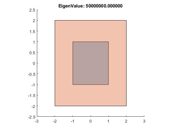

For example, if I under-integrate, there are now five zero-eigenvalues (with the two new vectors evincing the hour glass modes): I get these from my code. However, I have the same problem there. Matlab is just reporting back any combination of the displacements and rotations and the two hour glass modes.
So, the 'eig' command computes the eigenvectors of the matrix you put in (the stiffness matrix in your case). These are by definition orthogonal so NOT any combination of eigenvectors. You can check that yourself by computing ##\phi^T K \phi##: if that equals a diagonal matrix, then your set of eigenvectors are orthogonal.
In other words: your problem is really in your own computation, not anywhere else...

I do not remember the book. But I know that 30 years ago, I actually calculated them.
A few months ago, I asked if it was true, and someone responded
https://www.physicsforums.com/threads/the-8-mode-shapes-of-a-plane-finite-element.1014037/
However now that I had the time, I wrote the code myself and got similar shapes. And I recall, 30 years ago, in some book (I do not remember), that one can interpret the modes of a single element. And this would go a long way to explain why one must apply proper boundary conditions: to stop the free body mode.
I also recall doing it for an under-integration and seeing the additional two hourglass modes. I long since lost the work I did, and I cannot remember where I read it. But I KNOW that the book, back then, interpreted the modes of a single element like this.
Ok, if I look at the shapes that @FEAnalyst provided using Abaqus, they are also not perfectly in the two translation and single rotation form. The first three shapes there are also somewhat of a combination.
Yes and that is exactly my point. Three of those shapes are three zero-eigen value vectors.
And I KNOW the book, 30 years ago, said that they represent 2 translations and one rotation.
And I know that a repeated eigenvalue (in this case, zero) has eigen vectors that can be added and produce another eigenvector.
So I have a core belief that there must be a way to alter those first three eigenvectors from Matlab, to these three
(Numbering the nodes CCW from bottom left, with x-displacement followed by y)
1 0 1 0 1 0 1 0
0 1 0 1 0 1 0 1
1 -1 1 1 -1 1 -1 -1
Naturally, I would normalize themSee, I think it is a Matlab (not problem, but Issue). It reports back the fist three modes, but I KNOW that I once saw this as the three above

So, in that case you are asking the question how to scale and sum all eigenvectors to get [1 0 1 0 ...] right?
But that's an easy problem to solve (I assumed that you have your stiffness matrix K already defined):
[CODE lang="matlab" title="Scale eigenvectors"]
f = [1 0 1 0 1 0 1 0]';
[phi, lamb] = eig(K);
phi_inv = phi^(-1);
s = phi_inv*f;
# Now check:
f2 = phi*s
#f and f2 should be equal
[/CODE]
So, now you have a set of scale factors in the vector 's' that scales your eigenvectors such that the combination of eigenvectors results in f = [1 0 1 0 1 0 1 0]'.
If you are right, then 's' should only have non-zero values in the first three elements.

OK, I will do that tomorrow. I believe it will work. But my question remains: how can I get eig() to send back eigenvectors where *I* have some input into how it handles vectors from repeated eigenvalues?
I KNOW I did this with IMSL years ago.

Or this...
You showed me how to verify that the 1 0 1 0 1 0 1 0 is an eigenvector...
But how would I have known that to begin with?
How can I recombine the zero-eigenvalue eigenvectors from Matlab, to produce the pure displacements and the rotations?
Nope... the 10101010 vector is NOT an eigenvector... It is a linear combination of eigenvectors. So what is the defining property of an eigenvector:
if ##\phi## is an eigenvector of matrix ##K##, and ##\lambda## its eigenvalue, then it must hold that:
$$K \phi - \lambda \phi = 0$$
Now a bit of MATLAB code to show that this does not work for the 01010101 vector:
So, I've above shown you how to compute the vector s. That is literally what you are asking for. It is a vector that together with the matrix of eigenvectors combines to produce the pure displacement... So s is a list of scaling factors by which to scale all eigenvectors, and if you then add them all up, they become the pure displacement vector in x.
So, if only the eigenvectors belonging to the zero-eigenvalues can be combined to produce pure displacements, that means that the values of s belonging to the zero-eigenvectors should be non-zero. The other values in s should then be zero. Please check and let me know if that is true.
I am still not convinced.
If you wish, I can send you the entire Matlab code. But, for now, it produces the following stiffness matrix for a plane strain problem. YOUR code, above, used a random matrix.
Here are the material properties I used in the 3 by 3 D matrix
E = 20.;
nu = 0.15;
D = (E/(1-nu)/(1+nu)) * [1, nu, 0; nu, 1, 0; 0, 0, 0.5*(1-nu)];
When I do 2 point Gauss itegration in each direction, I get this as the stiffness matrix
K =
38.8747 11.7647 -21.4834 -5.6266 -19.4373 -11.7647 2.0460 5.6266
11.7647 38.8747 5.6266 2.0460 -11.7647 -19.4373 -5.6266 -21.4834
-21.4834 5.6266 38.8747 -11.7647 2.0460 -5.6266 -19.4373 11.7647
-5.6266 2.0460 -11.7647 38.8747 5.6266 -21.4834 11.7647 -19.4373
-19.4373 -11.7647 2.0460 5.6266 38.8747 11.7647 -21.4834 -5.6266
-11.7647 -19.4373 -5.6266 -21.4834 11.7647 38.8747 5.6266 2.0460
2.0460 -5.6266 -19.4373 11.7647 -21.4834 5.6266 38.8747 -11.7647
5.6266 -21.4834 11.7647 -19.4373 -5.6266 2.0460 -11.7647 38.8747
If you work with this matrix (you do not need to see how I got it, but I would be happy to post the entire code), you will get the eigenvalues and eigenvectors similar to the top of this thread (the ones a the top used a much higher Young Mod. However the, this current matrix has a MUCH lower Youngs' Modulus, and the eigenvectore here, REALLY LOOK like the first three are a pure translation, pure translatoin and pure rotation (with elements of each, combined)
If, however, I multiply the K, above, by any of these three, below (translation in x, in y, and rotation), I get the zero vector (informing me that each of these three is an eigenvector because they produce a zero vector when multiplied by K:
K * Mode 1 = Lamba * Mode 1 (where Lambda is the zero eigenvalue)Mode1 = [1;0;1;0;1;0;1;0]
Mode2 = [0;1;0;1;0;1;0;1]
Mode3 = [1;-1;1;1;-1;1;-1;-1]
In fact, I will post the results from Matlab. Unlike the ones above, these have a much lower Young modulus and notice that Matlab is BEGINNING to report the zero eigenvalue modes as pure translations and a rotation.
It seems to me that eig (From Matlab) is producing all correct eigenvalues and vectors, but I just do not like the eigenvectors it produces when the eigenvalues are repeated. I much prefer to somehow see two PURE translations and one rotaiotn.

end
And ignore some of the comments. I initially wrote it so that the detJ woud be 1 (and the local and global were the same)
Ah, I overlooked them indeed.
If I write this at the end of FourPointCounterCW:
[CODE lang="matlab" title="getS"]
Vi = V^-1;
s1 = Vi*Mode1
s2 = Vi*Mode2
s3 = Vi*Mode3
[/CODE]
Then I get:
[CODE title="s"]>> s1
s1 =
0.396662544532026
-1.660972854131425
-0.420967911592968
-0.000000000000000
0.000000000000001
-0.000000000000000
-0.000000000000000
>> s2
s2 =
0.925895125244109
1.077632183627960
-1.866168969125933
0.000000000000000
-0.000000000000000
0.000000000000000
-0.000000000000000
-0.000000000000000
>> s3
s3 =
4.105654396502303
3.321945708262850
0.841935823185934
-0.000000000000000
0.000000000000000
-0.000000000000001
-0.000000000000000
-0.000000000000000[/CODE]
You see that in all cases s is only nonzero for the first 3 values (ignoring numerical noise). Since the first 3 values of D are also zero, this means these are the vectors for pure translation and rotation. So now you can combine only the first 3 eigenvectors (which are for the pure translations and rotations):
[CODE title="check"]>> V(:,1:3) * s1(1:3)
ans =
1.000000000000000
0.000000000000000
0.999999999999999
0.000000000000000
1.000000000000000
-0.000000000000000
1.000000000000000
0.000000000000000

Quick question... why are you testing it by multiplying by the inverse of the stiffness?
I test by multiplying by the stiffness.
And even then, yes, I can see I recapture those modes.
But my core question has always been: why does Matlab report the first three zero-eigenvalue modes as combinations of "what I believe to be pure translations and rotation" I know the e.vectors FROM MATLAB are fine. I just don't like the way they look. That is what I am getting at.
No, I test with the original V, this is the test:
Code:
>> V(:,1:3) * s1(1:3)
because it gives back the original Mode1 vector which I used to compute s1.
I compute s1 with the inverse of the stiffness:
Code:
Vi = V^-1;
s1 = Vi*Mode1
s2 = Vi*Mode2
s3 = Vi*Mode3
So now you have the vectors s1 to s3 which contain the scaling values. You can use s1 to s3 to scale the first 3 eigenvectors (V(:,1:3)) to get back Mode1 to Mode3. In other words: you can use s1 to s3 to combine the eigenvectors for the zero value eigenvalues to get pure translation and rotation.
Code:
>> V(:,1:3) * s1(1:3)
Code:
Vi = V^-1;
s1 = Vi*Mode1
s2 = Vi*Mode2
s3 = Vi*Mode3
OK, I understand and I like that.
But now the closing question
Matlab reports these eigenvectors and I do not like the way they look. If I am a first time FE coder and I experiment to see the modes, and get those shapes, NOTHING in them informs me that three of the eigenvectors would have been MORE INFORMATIVE had I seen them as pure translations and one pure rotation. How would I have known this in advance. In other words: the eigenvectors from Matlab (sorry, there is no other way to say this) "displease" me (they are not pretty). The author of that book (from 30 years ago, I forgot the name), somehow KNEW this to be true (is that simply the mark of an intuitive engineer)? Did s/he get lucky getting pure eigenvectors, when s/he coded it for his/her book?
Good, because that was literally your question:
Because K is singular, so the eigenvalues are 0. This means that any any combination of the eigenvectors belonging to the 0 eigenvalues is also an eigenvector, this is not generally the case as I've shown before!
This being the case the algoritm in 'eig' needs to choose 'some' eigenvectors. Since the programmers didn't bother to make sure the end result was 'beautiful' it just comes up with some combination of eigenvectors which are valid.
Beauty is in the eye of the beholder... I think MathWorks thinks the result is absolutely pulchritudinous... But most importantly, they are correct...
This being the case the algoritm in 'eig' needs to choose 'some' eigenvectors. Since the programmers didn't bother to make sure the end result was 'beautiful' it just comes up with some combination of eigenvectors which are valid.Beauty is in the eye of the beholder... I think MathWorks thinks the result is absolutely pulchritudinous... But most importantly, they are correct...
THANK YOU.
Thanks for the comment, too, on what Matlab considers beautiful. That was my issue. I suppose the person who wrote the book, years ago, just knew it, and used an IMSL routine (and I used one), that just happened to spit them out in a way "I liked."
But I am happy with this, now
Thank you, again.
  • #31
Well, the zero-valued eigenvalues is a big give-away... They never occur for fully constraint problems.
  • #32
And, oddly, THAT was what I wanted to hear. Those last two sentences, were what I was looking for. And, now that you said them, it is obvious. I should have known that.
Thank you for patience (I know I can be stubborn -- sorry if it came across that way).
  • #33
Well, we took some detour, but we got there in the end :) All is ok!
