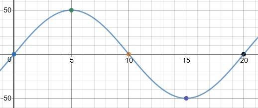

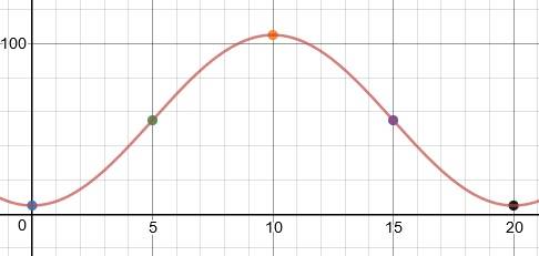

often times it helps to first make a sketch of the individual position graphs by plotting a few points
for x as a function of time, x(0) = 0, x(5) = 50, x(10) = 0, x(15) = -50, and x(20) = 0
plot those points on a graph of position vs time and note the points define a sine curve with equation x = 50sin(pi/10*t)do the same for y as a function of time, y(0) = 5, y(5) = 55, y(10) = 105, y(15) = 55, and y(20) = 5
plot those points on a graph of position vs time and note the points define an "inverted" cosine curve with an upward shift , equation y = -50cos(pi/10*t) + 55
You have the Ferris wheel moving in a counter-clockwise direction. (Shake)
Oops ... well, the y position curve is still good. Just reflect the x position curve over the horizontal axis making A = -50
That doesn't take away from your good advice of plotting points to see what the sinusoidal parametric curves are going to look like. :D
