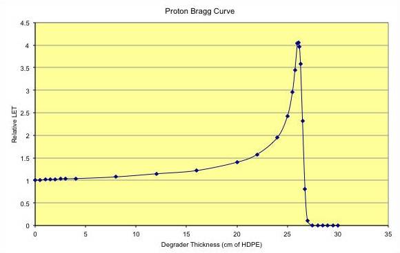

For heavy particles as protons and alpha particles at high energies like 100Mev they loose energy at an almost constant rate until the energy drops to about 10% of the original whereupon the rate of energy loss increases dramatically until fully dissipated.

My definition is a little more loose than yours i should have said that the energy loss varies slowly.
Bragg Curve for 205 MeV protons. Range in HDPE is 26.100 cm where the peak of the curve occurs. The LET at the entrance point is 0.4457 keV/micron in water.
This shape is characteristic of heavy particle energy loss with depth.
