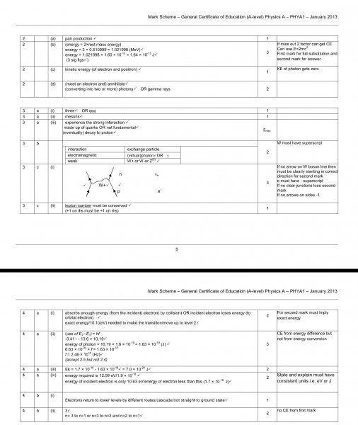

'If no arrow on W boson then must be clearly slanting in correct direction. E must have - subscript for second mark. If no clear junctions lose second mark. If no arrows on sides -1.'
If they are insisting on arrows on the W, they are wrong. Fermions get arrows. The W is not a fermion.
