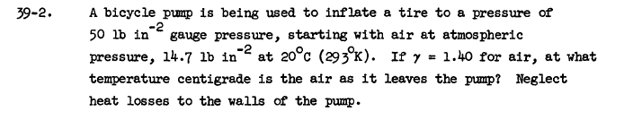

In summary, the assumption of an adiabatic process is not correct. The pump is adding energy to the system, and y = 1.40 does not help to solve the equation for the volume.
aa_o
24
See attached
P*V / T= constant
P*V^(y) = constant (if process is adiabatic)
I'm not sure that this is an adiabatic process. As far as i can read, it is adiabatic if no HEAT or ENERGY is added. But pumping in molecules that are a non-zero temperature is an addition of energy, no?
Anyway - my solution with the assumption of an adiabatic process.

The answer in the book says 173 C.
Are my assumptions about adiabatic wrong? Or am i using the wrong equations?
Can i really use P*V / T = constant if we are adding air molecules with the pump?
Any suggestions would be appreciated.
No. PV = nRT, and n is changing.
Okay. So the pump has a start state of:
P0 * V0 = n0 * R * T0
And end state of:
P1 * V0 = n1 * R * T1
I thus have 2 unknowns i need to solve the problem T1, which is what i need in the end, and the ratio of the number of molecules between the 2 states. I just can't find that extra connection that gives me the information about the ratio!
I still haven't used the fact that y = 1.40. I just can't see where that fits in.
Any suggestions?
Thinking about it again, if a constant amount of air is being compressed within the pump to 50 psig before being injected into the tyre (is this how the pump works?), then I think your original method is correct. But read carefully. The exit pressure is 50 psi gauge - what does that mean?
Thanks, mjc123.
So n is constant for the whole system (tire + pump), but the volume then changes (compresses).
Ahh, i think that gauge was the missing piece. I didn't know about the meaning of gauge and simply skipped over it without paying much attention.
With that information (P1 = P0 + 50) i get an answer of 174.5 - close enough to the one in the book.
No, n is constant for the air in the pump. As I read it, the pump compresses an amount of air from atmospheric to 50 psig, then injects it into the tyre (presumably the valve opens at that pressure).
Likes aa_o
Yeah, that makes sense. I think there was a lot of assumptions that had to be made that wasn't explicitly stated in the problem.
