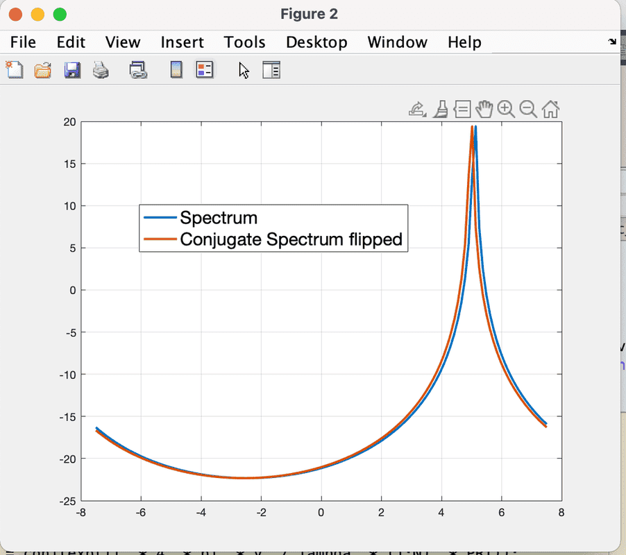

I am trying to understand why the conjugate of a signal in the time domain doesn't produce an exact flip of the frequency domain spectrum. There is always a one-pixel shift in the result.
The MATLAB code is shown below. I use a flip for the conjugate spectrum to show that it doesn't match the original spectrum and there is a delay of one resolution cell. I want to understand why this happens. It shouldn't as it is the perfect conjugate.

The graph has no issue at all. I have tested with Gaussian pulse in the frequency domain as well. It also has the same pixel shift. It is the issue of the conjugate. It shouldn't be like this. Probably something with the DC value which remains in the positive frequency always. I don't know. For simplicity, I used a monochromatic signal here. I usually do it with a Gaussian spectrum.

The problem is the combination of MATLAB's flip() and fftshift() functions.
After fftshift, the zero-frequency value is position 65 in the array indexed 1:128. After you flip, the zero-frequency is in position 64.

Thank you for the answer. My problem was indeed not the flip function. I just used flip to see if they coincide and it was indeed a bad choice as you pointed out.
However, my issue was more about the conjugate spectrum. Even without flip, you can see that both the spectra don't intersect each other exactly at 0. Screenshot attached. It is exactly one pixel after 0. That is why their peaks aren't exactly symmetric. You can see the values of abscissa at the peaks in the picture.
I found the fix actually. I was so dumb to use the frequency (velocity) axis wrong for the fftshift. It didn't include the zero frequency point at all. Now I define the axis like this.

Axis = linspace(-N/2, N/2-1, N)/N;
vel_axis = 2 .* v_amb .* Axis;
Now, here you can see the modified one with this velocity axis. They cross each other now at 0 velocity point.
