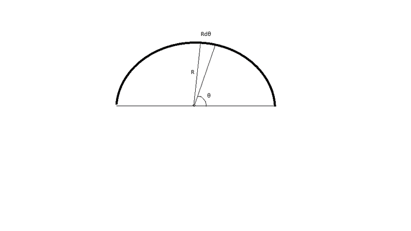

Alright so I've been working on this...and understand that this question want the field at the center of the circle
So here's what I've been doing...
Total Charge = Q
Charge per unit length = Q/L
For Part A...Q = Q/5 and L would be a half circle (pi * r) divided into 5 parts...so (5 pi * r)
So we would have λ = .2Q / (5 pi * r)
The charge on each slice will be dQ = λRdθ
So for a small portion of the electric field we would have
dE = kdQ / r^2 = (kλ / r) dθ
Now the components of the field will be
E_x = dEcosθ
E_y = dEsinθ
So for the total field we will have
E_x = ∫(kλ / r)cosθ dθ = (kλ / r) ∫ cosθdθ = (kλ / r)sinθ evaluated from 0 to pi
And
E_y = ∫(kλ / r)sinθ dθ = (kλ / r) ∫ sinθdθ = -(kλ / r)cosθ evaluated from 0 to pi
The x-components will cancel out...and the y-components will come out to (2kλ / r) right?
So would that be it? Knowing λ = .2Q /(5 pi * r) ?
Sorry for not knowing how to make that look nice...not too veteran here just yet :P
Can anyone let me know if I went completely off...or something is right :) thanks again!
What's 5 pi * r? That's two-and-a-half times around the circle!
E_x = dEcosθ
E_y = dEsinθ
And
You seem to have confused two approaches. The cutting into 5 parts approach should be an approximation that avoids calculus. I would assume you are meant to represent each of the parts as a point charge. λ=Q/L, where L is the total length of the arc, πr, in all cases.
Your exact calculus solution looks right (except at the end where you plugged in the wrong value for λ).
haruspex said:
What's 5 pi * r? That's two-and-a-half times around the circle!.
Oh wow was that a mistake...what got me confused on that was I was looking at it as
(1/5) (.2Q / (pi * r)) which then lead me to the (5 pi * r)
alright so then it SHOULD be ,if wanting to use decimals here, (.2pi * r)
Well that's interesting...now the (.2)'s cancel and we only have the Q/(pi *r)? Is that correct?
Yes, but as I posted, for the exact (calculus) method there was no point in going through that 0.2 stuff in the first place.
You are asked to use two methods. In one you cut it up into 5 or 9 pieces and apply some simple approximation - no calculus. In the other, you keep it as a single piece and apply the calculus method you posted.
