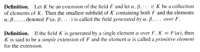

As indicated above I need help in order to make a meaningful or significant start on the solution to this exercise .. ...Exercise 13 of Section 13.2 reads as follows:
Definitions that may be relevant to solving this exercise include the following:

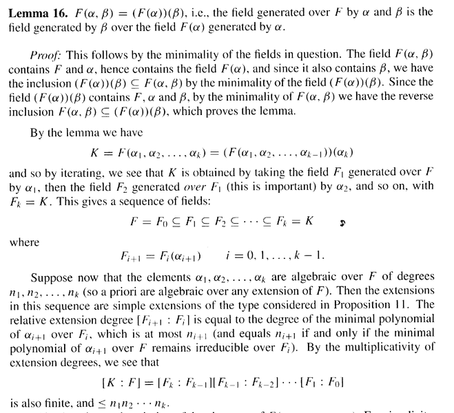

A result which seems relevant is Lemma 16 plus the remarks that follow its proof ... Lemma 16 and the following remarks read as follows:
