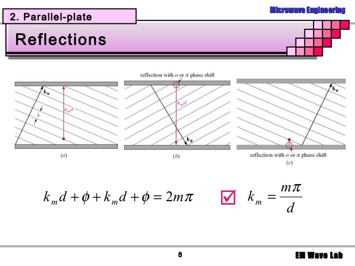

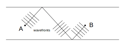

Let's look at this image: in Figure (a), a wave coming from left propagates with a certain [itex]\mathbf{k_u}[/itex]. It then bounces a first time (in the upper plate), as in Figure (b), and a second time (in the lower plate), as in Figure (c). Textbooks basically say that, given a point A in Figure (a) where the original wave has phase [itex]\phi_A[/itex], at the same point in Figure (c), after 2 bounces, the wave should have the same phase it had in Figure (a), [itex]\phi = \phi_A + 2 n \pi[/itex]. Then the condition you mentioned is derived.
If it is satisfied, the wave is able to regenerate itself along the guide, because after every couple of bounces it constructively adds with itself.
I know that when, for example, [itex]\phi = -\phi_A[/itex], the wave destructs itself; but a lot of other intermediate situations can occur, where [itex]\phi[/itex] is different both from [itex]\phi_A[/itex] (perfect constructive interference) and from [itex]-\phi_A[/itex] (perfect destructive interference). And at a first glance I can't state that these waves will cancel. Why in all these situations the wave always and anyway destroys itself, so that only waves with [itex]\phi = \phi_A + 2 n \pi[/itex] can be accepted?
I don't think this is a difficult question, just I can't figure out the problem. The question can be asked in a simpler way.
A plane-wave is propagating with a certain angle of incidence into a parallel-plate waveguide: it will bounce off the upper plate, then the lower plate, and so on. Why can this wave survive into the waveguide only if, after every couple of bounces, it regenerates itself?
Best case is [itex]\phi_B = \phi_A + 2 n \pi[/itex]: this is (according to textbooks) the only acceptable case.
Worst case is [itex]\phi_B = -\phi_A + 2 n \pi[/itex] and the wave cancels itself.
But between the above two limit-cases there is an infinity of intermediate situations, where in B the wave has a phase which is nor able to cancel itself, neither able to regenerate itself. If the wave is not completely cancelled, why cannot it propagate anyway along the guide?
I think the key is not that it regenerates itself but rather that it is itself. The phase relation only ensures that you are describing the same wave and not a different one shifted in phase.
Likes EmilyRuck
Ok, it could make sense. So we are stating that a wave which can't be always itself along the guide, can't propagate there. Why are we so sure about it? I mean: a wave can change along the guide, without destroying itself.
