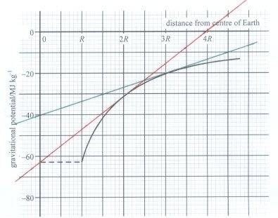

By use of the graph in part (a), calculate the gravitational field strength at a distance 2R from the centre of the Earth.
g = delta V / Delta r filed strength is the potential gradient
I have drawn the gradient on at 2r=R and calculated it. I have also done another at 3R to check what is confusing me.
I've just written out the equations; if V=GM/r and you divide that by r you get GM/r^2, which = g. So this must be valid for any point. In that case, why bother with the inaccuracy of drawing a tangent? Why not just read off the value of V at that value of r??

If you know the exact shape of the potential everywhere, you can calculate the gradient, of course.
In general, this does not have to be true. Inside earth, for example, force and potential are more complicated functions.
Thanks mfb for responding.
So will the potential at any point divided by the distance to that point always equal the gravitational field strength or is this because my potential function has this shape?
So if
g = \frac{\Delta V}{\Delta r}
Can why can we say that V at that point divided by the distance is equal to g?

It works if you have a single, spherical symmetric mass at the origin (in 3 dimensions), and consider the potential and force outside this mass, where the potential is defined to be zero at infinite distance.
It fails as soon as one of those conditions is not true.

so in my particular case it works for the potential GM/r
but the general case is [tex] g = \frac{\Delta V}{\Delta r} [/tex] is always true.
