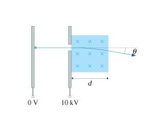

An electron in a cathode-ray tube is accelerated through a potential difference of 10 kV, then passes through the d = 2.4-cm-wide region of uniform magnetic field in the figure(Figure 1) .
What field strength will deflect the electron by θ = 13 degrees?

The magnetic force is perpendicular to the velocity. In F = q v B sinθ, θ = π/2. The angle that you seeking has to do with the circular arc of the electron's trajectory.

This is where you went wrong. What I am trying to say is that the electron undergoes uniform circular motion in he region of magnetic field. The acceleration is centripetal.

Remember that the electron is undergoing uniform circular motion. Can you write expressions for the x and y components of its position as a function of time? Note that at t = 0, the electron is at position {0, mv/qB} and moving with velocity {v, 0}.

Please forget the equations that you quoted. They are not pertinent to uniform circular motion. In uniform circular motion the object is going around a circle at constant speed. This would be the case here if the magnetic field extended over a larger region. Instead the particle exits the field, nevertheless while it's still in the field region, it moves at constant speed.
Try this approach. Draw a picture of the particle at the exit point and a vector from the center of the circle (remember it has radius mv/qB). The x-component of the position vector must be what?
The x-component of the position should be the length of box containing the magnetic field (xf-xi)=0.024 m, and the y-component of the position should be y=(0.024)tan(13).
Using geometry, I think the radius of the should be (Δx2+Δy2)/2Δy, which should be 0.05476 m. Then I should be able to put it in the formula B=mv/rq. Does this sound correct?

Draw a diagram showing the arc of travel and the centre of the arc, joining the centre to the ends of the arc with two radii to form a sector.
What is the angle in the sector, i.e. between the radii?
In terms of that angle and the radius, what is the distance traveled along the x axis?
