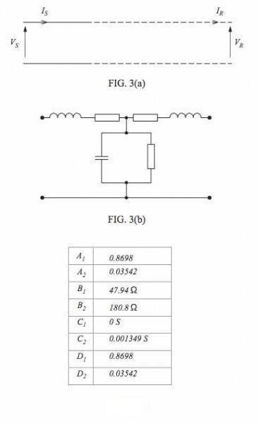

Figure shows a 50 Hz, high-voltage, transmission line. The relationships between the sending and receiving end voltages and currents are given by the complex ABCD equations:
where 'S' stands for sending-end and 'R' stands for receiving-end
(a) Given the parameter values in TABLE C and an open-circuit received voltage measured as 88.9 kV, calculate the values of
and
and hence the power
absorbed from the supply by the transmission line on open circuit. Vs= 77.33kv + J3147.06v Is= 0 + j119.93 A P= 377.43kW
(b) If the line is modeled by the T-circuit of FIGURE 3(b), see if you can estimate the primary line coefficients R, L, G and C. The line is 50 km long.
Regarding part b) this is what I have at the moment but not sure I am doing it correctly.
A= 0.8698+J0.03542 B= 47.94+J180.8 C= 0+J0.001349 D= 0.8698+J0.03542
This means that A and D a symmetrical A=D.
I don't really know where to go from here as I have looked at other posts on this question and they don't seem to make much sense due to lots of people asking several different questions.

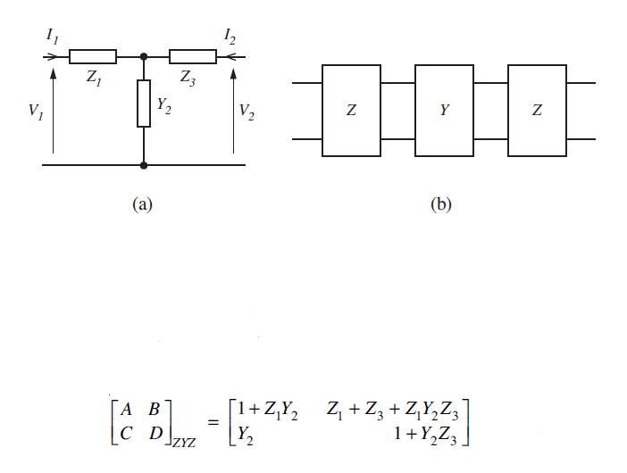

Also Z1= Z3 =1/2 (R+jωL)δx and Y2= (G+jωC)δx Where δx= line length.
But I don't know how to get from the matrix to Z1, Z3 and Y2
