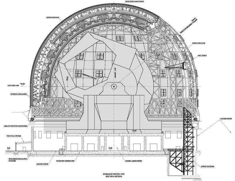

Assuming the dome will not spiral away using a single motor and is set up in a manner such that it would rotate in place, I want to find the minimum torque needed to rotate a fairly heavy dome if a motor was located on the dome's inner face.
I understand that this is an issue that deals with the moment of inertia, but I'm not entirely sure how to apply it to this specific problem. Any input on the issue is much appreciated.

A heavy dome rotating about a vertical axis like the one in the picture?
Usually it's all about friction. Once the dome is moving it usually takes less torque than what is required to get it moving. Is it possible to just measure it? Can you push on the dome and measure the force needed to get it moving?
Yes! It is actually quite the coincidence that you brought up an image of an observatory because that is what I intend on building.

How big? How heavy? Can you just rotate it by hand, or will it be so large that it will definitely require external power to rotate?
Please share as many details as you can.

No. Your MOI is negligible, and bearing friction will dominate. I have a crystal ball in front of me that tells me that...

How is the dome supported. It could be low friction but not without a lot of engineering effort. Then any additional force (torque) will cause the dome to (angularly) accelerate

The plan is to rest the dome on top of an open cylinder and create a platform on the top of the cylinder so that a motor could rotate the dome. I don't have an idea on the exact material I will use for the platform, but I have a feeling it will end up being made of wood or some 3D printed material.

I didn't quite understand this. Will you have some type of bearings or wheels to support the weight of the dome and allow it to rotate?

There will be wheels attached to the motor. The wheels themselves will be on the platform and that allow the dome to rotate. Sorry if I wasn't clear on that.

Practically, you could use almost any torque, because your rotational velocity can be very small in this case.
The inertia of that big mass should be considered for starting and precisely stopping the rotation.
The friction of all the driving and guide wheels, electrical tracks and transmission mechanisms, under windy conditions, should be also considered.
It seems to me that this analysis may be a little early in this project, if structural solutions have not been engineered yet.
Well, I can give you an idea from an astronomical dome that I'm familiar with. The dome is about 10 meters in diameter and covered with metal sheeting. It probably weighs several tons, but I don't really know how much it weighs. It is supported on about 100 wheels that run in a track around the perimeter of the dome. Four of these wheels have 3/4 HP motors that drive the rotation of the dome, spaced 90 degrees apart around the dome. Your dome is probably smaller and lighter so could use smaller motors.
