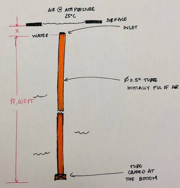

Hi everyone,
I'm working on a first-year college assingment and need some help with it.
I need to figure out how deep does a tube, initially filled with air, need to be submerged into water in order get fully filled, meaning in order for the air to be fully displaced by water.
The tube is 1/2 inches, 10,000 ft long, and it's capped at the bottom.
The hole (full of water) where the tube is submerged is infinitely long and vertical.
I'm attaching a picture for clarity.
Questions:
1. I would appreciate some help picking the right model/equations to find "x": how deep does the inlet of the tube need to be for it to get fully filled with water?
2. I also wonder if some solubility (Henry's Law) comes into play.
3. The first variation of the assingment states that the temperature is higher at the bottom (350 F) yet remains 77 F at surface. It asks what could happen then. My guess is a gayser might happen, but what do you think?
Thank you!
Not sure what long and vertical means. So the water is infinitely deep. But I am wondering how broad the hole is. Would the distance from the water surface down to the top of the tube decrease as the tube fills? Your figure looks as if there are no sides to the hole. If so, my "distance from the water surface down to the top of the tube" would remain constant.
I think we all need a better description of the problem. As is, the answer seems obvious to me, x=0 as berkeman said above. That makes me think I don't really understand your question.
Perhaps as a point of clarification: If the water fully fills the tube ("displaced") where does the air go? How (where) does the water get in?

As per the statement of the assignment the hole is infinitely long = deep. Just condirmed it is also infinitely wide too.
The tube is vertically submerged in the hole.

To your question, this is all the info we were given to solve this open-ended question!
Getting mor feedback from the class, the point of discussion is to tell how much water head-pressure is needed to fully displace the air in the tube, meaning up to which depth would the tube need to be submerged for the entire it to get filled with water. Considering the tube has a diameter of 0.5 in and is 10000 ft long.
Some thoughts I've been having are regarding a potential capillary effect, since the tube has a small diameter and is so long. Also, would I need to consider the solubility of air in water (Henry's Law) at all?

Have you studied some stability criteria for vertical fluid flows in very narrow aspect ratio tubes against air? Is there some wetting or capillary effect that you've studied that may apply? And the problem says nothing about the tube not being shaken or vibrated, so even if there were a stable condition where the air bubble resisted the flow of the fluid, that could be defeated with vibration of the tube (think of clearing air bubbles from IV lines...).
I think that it is important to first articulate what is happening in this system mechanistically. I see the water entering the top of the tube and flowing downward around the periphery of the tube (annularly) while the air flows upward up the center of the tube. Is this what others envision?
