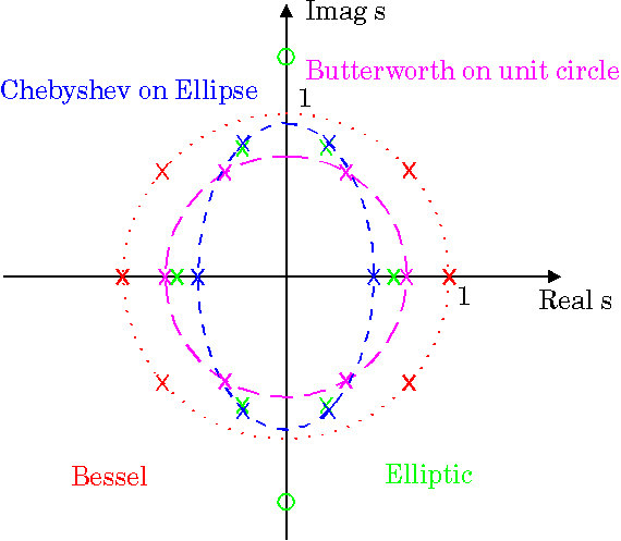

Basically as you traverse the unit circle from 0 to 2*pi in the Z plane ( or the jw axis in the s-plane) you can consider the distances to the poles or zeros for their effect on that frequency.
Don't get mixed up whether you are viewing s plane or z plane.
The difference between pole zero plots for digital (Z) or continuous filters (S plane) is whether you traverse the unit circle (Z plane) or the jw axis (s-plane).
The amplitude at a frequency is the product of magnitude of the vectors from that point to all zeros divided by product of magnitude of the vectors to all poles
Generally the filter is designed in the S-plane and then transformed to a digital equivalent (by bilinear transform or whatever)
There are lot of examples of pole zero positions on the s-plane in google images. Just look up the filter type, for example
chebyshev filter pole zero s plane
chebyshev filter pole zero z plane
Here is an s plane example.
