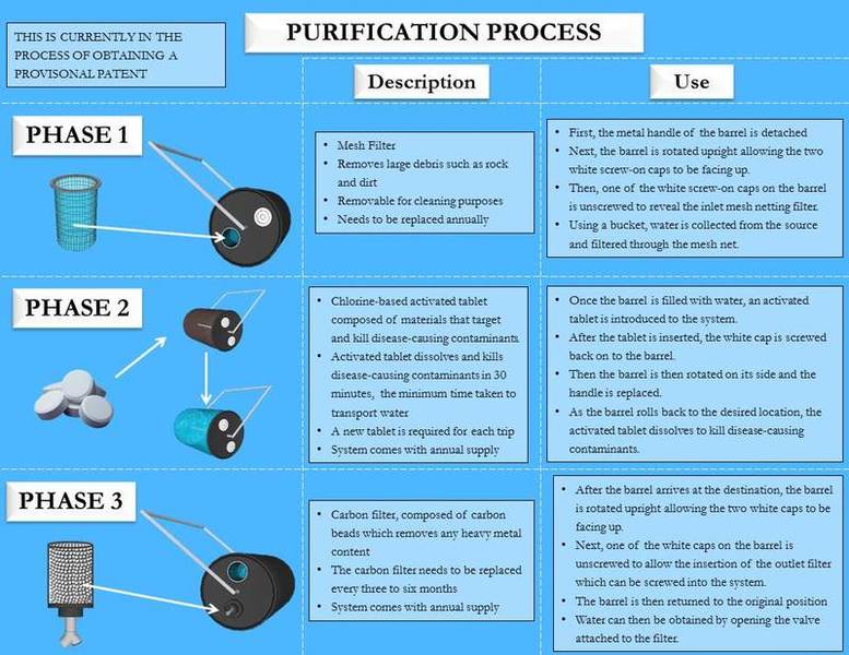

I am working on a project that still in early phase of development. The idea is to create a water filter system to in a barrel as rolling it. Basically the barrel will contain 4 panels placed inside the barrel creating a shape of (+) sign in the barrel. The panels will contain activated carbon to filter the water and a mesh of 1mm holes. Let's say the barrel can carry 20gal of water. Is it possible to filter the water by rolling it for a 2 hrs duration using this concept? If not what would you suggest?
Note that there will be a gap right in the middle of the 4 panels. So they are not connected.
Typically filters are used in such a way that the fluid flows through the filter. This helps ensure anything caught by the filter stays upstream and doesn't pass through with the water. I'm not sure that an "agitation type" filter would be as effective.

This application is different. It utilizes a coarse mesh pre-filter when water is poured in the tank, chlorinated tablets, and an activated carbon filter that the water passes through when it is drained from the tank.
See here:
