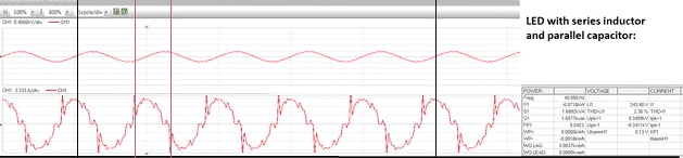

So I put a 14.25mH in series with the active. Subsequently, the THD went up to 23+%!
I don't remember what the PF did.
'Interesting'; then I thought about it and my working hypothesis is that the LC resonant frequency for this is about 114 Hz. So perhaps 114 Hz is too close to the first and third harmonic?
But in conclusion, I'm not entirely sure why it decreased the performance so much when I had the inductor in series, and the capacitor in parallel, I initially thought it would be like an LC filter, but I have a suspicion that it was resonant on the third harmonic. Even then I'm not sure how that works. Thoughts?

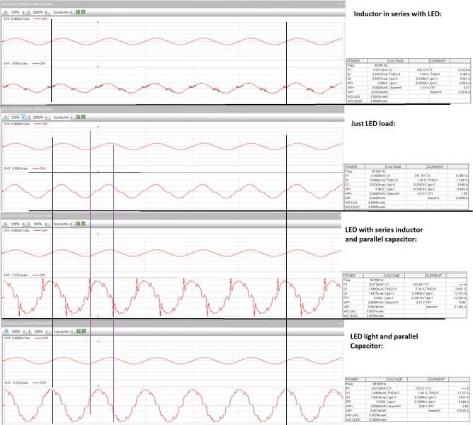

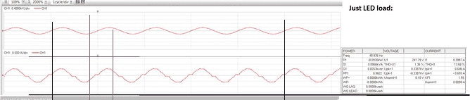

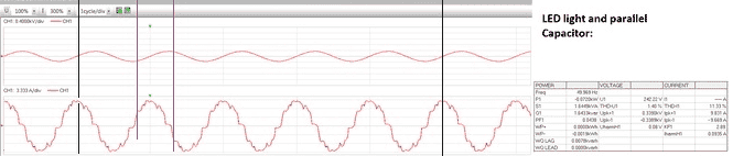

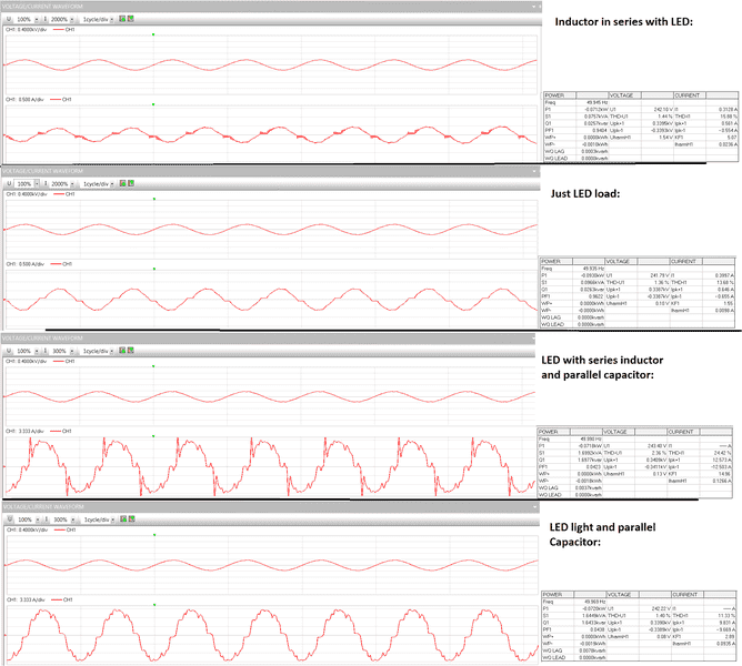

Please find attached a comparison of the waveforms and DMM values.
When the load was just the LED, was it slightly leading or slightly lagging? (Also, 14% THD still seems quite high to me.)
You can see the approx -j23 Ohms in parallel with the load does draw more quadrature current. Do you think resonant frequency is the cause of increasing the THD when there was both an L and a C in/on the circuit?

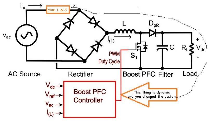

Thank youP.S. I presume that the light works something like Example 2. here:
https://www.allaboutcircuits.com/technical-articles/understanding-thd-total-harmonic-distortion-in-power-systems/
Does S1 switch at a high frequency? If it is this circuit, I still do not understand how the alone capacitor on the supply could distort the supply so much.

It was only an inductor before the load. As you can see from the #3 'waveforms.png' DMM table, it didn't really do anything to noticeably decrease the voltage on the LED. The supply oscillates from 240V-245V anyway, and the inductor was only 14.25 mH.

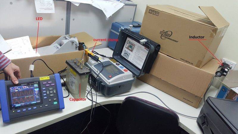

That's pretty crazy (not you, your data). Can you post your test setup?

Your plots show voltage and current to the LED alone out of phase.
That seems counterintuitive , unless it's a 'darkness absorbing diode'? :sorry:
So I inverted all your current traces and added vertical black lines at a couple voltage zero crossings.
Phase shift due to capacitor is evident, so i guess your current measurement was upstream of that.

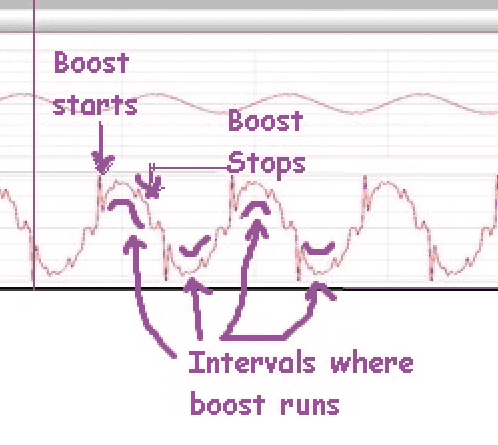

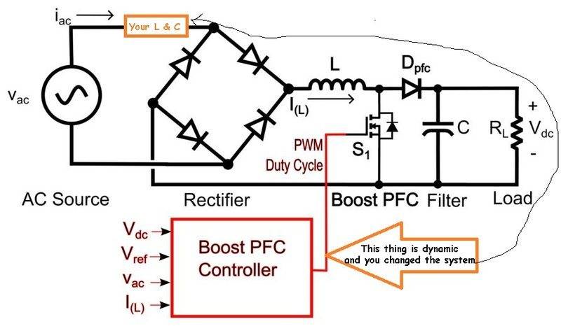

Presence of both inductor AND capacitor seems to offend your LED lamp. I added vertical purple lines at the upsets. Interesting, they occur just after voltage peak.

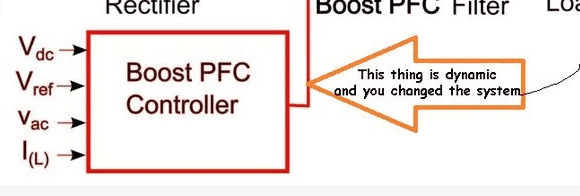

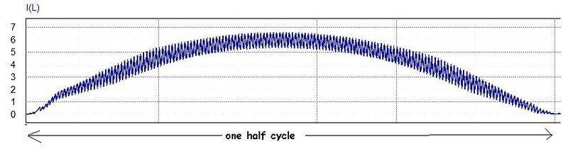

If it is as you suggest, active PFC, then
My guess is they interact with the closed loop controller inside your lamp base . Did it sound strange ?
https://www.allaboutcircuits.com/technical-articles/how-the-boost-pfc-converter-circuit-improves-power-quality/
the one referred to in your link
Here's the current waveform it's trying to draw. (Ignore amps numbers , you didnt measure yours)

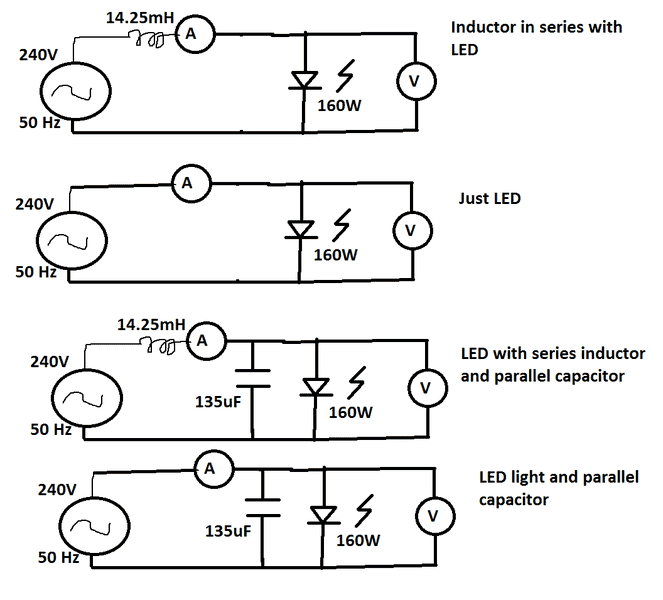

You didn't say which you placed adjacent the lamp, inductor or capacitor.

In keeping with the waveforms.png, here is a list of the circuit diagrams and a photo of the setup:

Hopefully my last diagram and setup pictures will be of use to you Jim. I'd like to get closer to the bottom of this phenomenon, because filtering non-linear loads is interesting to me. As does THD.
H'mm that is an interesting observation.
My power electronics knowledge is a little bit rusty, but I remember a little bit (duty cycles etc.) No, the LED didn't sound strange, but the inductor certainly did on start-up, and it was humming quite a bit, more than I'd have expected given that I wound it around powder core toroids.
Remind me, so if that's the current waveform it's trying to draw, is that sharp triangular characteristic just a result of it not being able to draw a perfect sinusoid, so that's the best it can do?
That flat blip around the zero crossing, when it's just the LED load, what's causing that?
I imagine that the LED is forward biased 100% of the time through the aid of inbuilt capacitors, so what is not able to keep up just before/after the zero crossing to cause it not to draw any current then?
Well, we're speculating that it's this kind of device
in which C is likely charged to > peak value of Vac by the boost converter.
When Vac is near its zero crossing, ie very small, there's nothing to push current through L and S1 so no current can flow during a brief interval surrounding each voltage zero crossing. Hence the flat spots in current waveform ?
That's explained in the link
These currents are the general shape that they should be (sinusoid/rectified sinusoid), but one thing that stands out is that the lines of the signals look thick. This thickness occurs because during one cycle the current ramps up and then ramps down as the average current is controlled to track the reference sinusoidal voltage.
Zooming in on the inductor current reveals the repeatedly increasing and decreasing currents of the inductor as the system switches between the two states.
That's explained in the link.

I have no idea if the light had a resonant frequency, or if it did, how I would have calculated it. If it did have a resonant frequency LC in it, I would imagine that it would be much higher than the supply 50 Hz.
If that thing works as you suggested, with a full time internal boost regulator for PF correction,
that internal boost regulator is an active device with its own transfer function.
It has feedback so its transfer function has a denominator
and that implies gain and damping and a natural frequency.
All three of which we know zero about.
Changing conditions at its input, like adding series inductance, changes its response and we can only guess how.
tim9000 said:
As I said in my OP, from what I calculate from my L and C, they're resonant frequency for is about 114 Hz. I have no idea if the light had a resonant frequency, or if it did, how I would have calculated it. If it did have a resonant frequency LC in it, I would imagine that it would be much higher than the supply 50 Hz.
we can only speculate from your observations, the graphs.

How would it have interacted with the lights internal resonance?
Piano - in the middle the night when you're trying to sleep you'll hear the strings go into sympathetic vibrations with noises , like a conversation in next room or a radio nearby or something outside.
How interact ? Inductance in series (without parallel capacitance) adds to that of boost regulator's internal L , affecting regulator response.
I'll speculate too now.
All your voltage traces look the same. Text block on right is too small and blurry to make out.
LED alone
voltage = ~2 div P-P , reasonable approximation of a sinewave
current = ~ 2.3 div p-p, in phase with voltage, flattened at top and at zero crossing. Looks symmetrical so distortion is odd harmonics.
LED and capacitor
Voltage looks same so current drawn by LED shouldn't change.
Current now up to about 5.9 div p-p and shifted nearly 90 deg ahead of voltage. That suggests increased current is all drawn by capacitor.
Exaggerated distortion in current wave looks to me like high harmonics , 7th or 9th is evident which suggests this thing is powreed by a Ferroresonant Voltage Regulating transformer (Sola or something).
Capacitor bank is much lower impedance at harmonic frequencies so the harmonics are visible there in the current signal long before you'll notice them in the voltage waveform. A crude high-pass filter if you will.
Current through capacitor alone probably won't look much different.All 3 loads ---- same as last one but with series inductance 14.25 mh = 4.48 ohms @ 50 hz, higher at each harmonic by the order of that harmonic
Voltage looks the same to me still ~ 2 div p-p.
Current wave still about 5.9 div p-p but with those new spikes shortly after voltage zero crossing... what's going on there ?
I'll venture a USWAG(Unscientific Wild A** Guess)
That thing's boost converter does not run for complete line cycle, just near voltage zero crossings.
It starts after peak to maintain current into LED's internal filter capacitor and stops before next peak
the spike is overshoot on booster startup , inductor is higher z at switching frequency so the first few gulps of current deplete the capacitor.
That's my best guess from your observations.
What do you conclude ?
My Automatic Control theory is very rusty. So the TF is the Output/Input from memory, which IS the gain? So Why does the gain having a denominator imply the feedback having a damping and natural frequency? (Hopefully that question was reasonable)
Could you please elaborate on what a 'Ferroresonant Voltage Regulating transformer' is and what it is comprised of?
Interesting theory. One thing I still don't quite get is when you said "Capacitor bank is much lower impedance at harmonic frequencies so the harmonics are visible there in the current signal long before you'll notice them in the voltage waveform. A crude high-pass filter if you will."
wouldn't it be a low pass filter? Because the Capacitor is in parallel with the load, so at each higher harmonic, won't it be closer to a short across the load?
Another similar thing that is still playing on my mind is, if you have an LC circuit, (L in series, and C in parallel) circuit such as this, which feeds the load, if your supply is operating at 60 hz less than the resonant frequency of this LC circuit, does being that close to the resonant frequency have any effect? (Assuming so, how would I calculate it? Say I'm operating at 50 hz, and rf is 114 hz)
Well, if nothing else, I've learned the danger of trying to play with active components.
Thanks again
Trabnsfer function includes time response , forward transfer function is just say G , no denominator
Wrap feedback H around it and the transfer function becomes G / (1 + GH) , aha, it sprouted a denominator
Both numerator and denominator are complex.
Any frequency that makes the denominator small compared to numerator increases its gain.
Indeed the higher the harmonic the closer to a short is your capacitor bank. So the harmonic content of CURRENT will be higher than it would for a resistive load.
You plotted current and it's mostly through your capacitor bank, so its harmonic content compared to a voltage plot will be exaggerated . The capacitor high passes current and that's what you plotted.
Sola transformers have third harmonic filters and claim 3% total . Much of that is higher harmonics. I measured after an R-L high pass in my rod position system 7th 9th and 11th of several per can't i don't recall exactly how much..
Use your basics.
About an octave away from resonance? That depends on Q, doesn't it ?
I think the "forward transfer function" is also referred to as the 'open loop transfer function', which rings a bell.

tim9000 said:
does this mean that the detrimental impact of the THD on the supply, did not actually get worse when the capacitor was inserted into the circuit?
That's what i surmised from the voltage wave.
I assumed you're plugged into a wall outlet that's pretty stiff.
The change in current wave when capacitor added suggested to me the voltage wave has higher order harmonics in it .
Wait, so you mean the THD on the supply didn't get worse only because I'm plugged into the infinite bus on the wall? Or because the total load actually didn't draw/create more THD?
Are you saying the THD from when the capacitor was coming in was higher order harmonics already in the supply? Because, it only occurred when the inductor was also present (hence why I thought it was related to resonant frequency).
With a ferroresonant transformer, what is the significance of the capacitance value? I assume it's related to the inductance, but is this the inductance of the secondary, or both primary and secondary...or just primary inductance? And how far is the secondary part of the core into saturation, by design for normal operation?
Cheers
that's what i would guess.
Wall outlet capacity is large compared to the light .
135 uf at 50 hz is 23.5 ohms? So you had almost ten amps through the capacitor and one through the LED? So that current is 90% capacitive and 10% LED ?
How much of each harmonic is available to drive current through the capacitor? What is Z of capacitor at each harmonic ? If you had Fourier coefficient of each harmonic in the voltage and the current waveforms you could check to see whether they're in proportion.
That's exactly what i hypothesized to explain your observed current wave.
What experiment could you propose to test that hypothesis?
What did you conclude from the waveform ?
It determines how many amps per volt you get at every frequency present in the voltage wave.
That your 90% capacitive current changed shape when you added inductance in series with the source suggests that it blocked some higher harmonic currents, which should change the current wave shape.
That it looked different on opposite sides of the current peak suggests something else was going on too. That's why i hypothesized LED has part cycle power factor correction.
Have you never done the exercise of constructing on graph paper an arbitrary waveform by adding together a fundamental and harmonics? If not , try it.
Well that is what I would have expected, however the THD went UP to 23%, so as you say, some other problem, which we may not be aware of, is popping up.
Makes perfect sense, but doesn’t help clarity.
If I still had the LED light, I could maybe set up an alternate supply, from a generator, and see if the same effects were observed. Either that or modify the set-up, I could still set-up but with a regular incandescent light.
I conclude from my waveforms that if you want to add reactance, that it has to be in in proportion with the load, otherwise you make a bloody mess

I'm going to check which harmonics went up when the inductor was in series, because I'd have thought that the higher order ones would decrease (yet the total harmonic dist did actually go up).

rbelli1 said:
Try putting just the L and C components on the powerline with no light.
BoB
Hi Bob,
See, this is what I'm not sure about: The resonant frequency for this will be 114.7 hz, the Cap will be -j23.6 Ohms @ 50 hz, the inductor j4.48 Ohms @ 50 hz.
So I expect this would mean that the current would be 240V/(j4.48 - j 23.6) = j 12.6 A (which is a fair bit, but less due to a small amount of resistance)
But what I was expecting was that there was a relationship between the resonance between LC and the parallel load, so you could calculate how much of a 'short' that cap was acting as, at whatever frequency. But maybe resonance is just a rough guide and maybe you have to calculate it as per basic circuit theory (i.e. parallel impedances, KVL, KCL).
Cheers
Well if you put the LC in there with no light and get identical results as before you know it is not the light. If you get perfect sine waves then you know it is the light. In between is part both.
Do you still have access to any of the parts?
BoB
We learn AC circuit theory with linear components and sine waves.
As soon as we encounter a nonlinear device and distorted sine waves we have to decide how much of a compromise we will settle for and analyze to that.
Ferroresonant transformers operate well saturated and run hot to the touch.
Most have a third harmonic filter to improve the sinewave output but higher ones sneak through.
