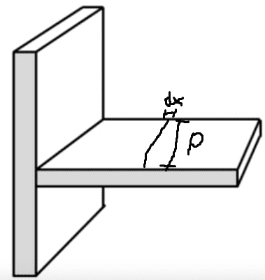

I'm trying to deduce the differential equation for temperature for a triangular fin:

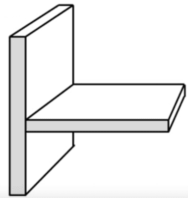

I know that for a rectangular fin, such as:
I can do:
Energy entering the left:
[tex]q_x= -kA\frac{dT(x)}{dx} [/tex]
Energy leaving the right:
[tex]q_{x+dx} = -kA\frac{dT(x)}{dx} - kA\frac{d² T(x)}{dx²}dx [/tex]
Energy lost by convection:
[tex]dq_{conv} = h_eA(T-T_e)[/tex]
[tex]dq_{conv} = h_eP(T-T_e)dx [/tex]
[tex]q_x - q_{x+dx} - dq_{conv} = 0 [/tex]
[tex]q_x = q_{x+dx} + dq_{conv}[/tex]
[tex]-kA\frac{dT(x)}{dx} = -kA\frac{dT(x)}{dx} - kA\frac{d²T(x)}{dx²}dx + h_eP(T-T_e)dx[/tex]
[tex]kA\frac{d²T(x)}{dx²}dx = h_eP(T-T_e)dx[/tex]
[tex] \frac{d²T(x)}{dx²} = \frac{h_eP(T-T_e)}{kA}[/tex]
But I don't understand why A = Pdx on the energy lost by convection, so I don't know how to adapt that for a triangular fin.

There are two areas involved here, one perpendicular to the flow of heat in the x direction (which you call A), and the other perpendicular to the flow of heat from the fin surface into the surrounding air (which is Pdx). For a fin with triangular shape, A is decreasing with x, and P is about constant. Also, since A is a function of x, when you do your heat balance on a differential section of fin, the area A must stay inside the heat flux derivative.

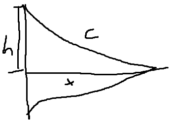

What I've posted here is just a portion of an exercise I was doing, I would then have to solve the ODE to find an equation for T(x). So now I need to get rid of this derivative of A(x). To be honest the only thing I can think of to proceed from here is to find an equation for A(x) and derivate it.
[tex]A(x) = 2h(x)P[/tex]
[tex]c² = h² + x²[/tex]
[tex]h(x) = sqrt(c²-x²)[/tex]
[tex]A(x) = 2sqrt(c²-x²)P[/tex]
[tex]\frac{dA(x)}{dx} = \frac{-2Px}{sqrt(c²-x²)}[/tex]
[tex]\frac{d²θ(x) }{dx²} = -\frac{m²θ(x)sqrt(c²-x²)}{2Px}[/tex]

If P is the dimension shown on your diagram, then the differential heat balance should read:
$$k\frac{\partial}{\partial x}\left(A(x)\frac{\partial T}{\partial x}\right)-2Ph(T-T_e)=0$$
Also, from the figure, A(x) = P t(x), where t is the thickness of the fin at location x. So:
$$k\frac{\partial}{\partial x}\left(t(x)\frac{\partial T}{\partial x}\right)-2h(T-T_e)=0$$

I don't think I expressed myself properly before but anyway, finally managed to get it in the way I wanted:
http://i.share.pho.to/0a247f78_o.jpeg
http://i.share.pho.to/57739467_o.jpeg
[tex]T(x) - T_e = θ(x) [/tex]
[tex]m = \frac{h_e(L/e)(1+(e/L)²)^{1/2}}{k} [/tex]
[tex]xθ'' + θ' - mθ = 0[/tex]
Just need to solve that now.
