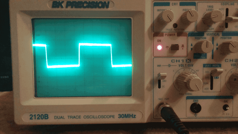

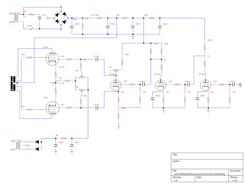

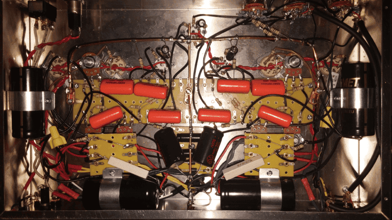

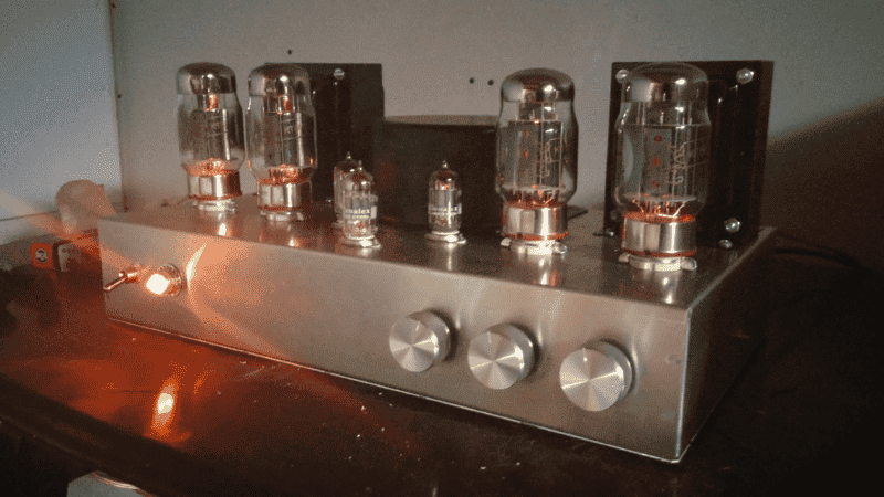

Thought I would share my latest project. I decided to make a stereo amplifier out of Vacuum tubes. I think I finally have the noise and distortion levels as low as I can get them. The amplifier outputs about 88W rms per channel before it clips the output.
Here is the internal wiring
This is a schematic diagram of a single channel. This is mirrored for the left and right channels.
Here is what the 1kHz square wave output looks like. There is clearly some attenuation at low frequencies as can be seen from the shallow slope at the peaks of the wave. I'm not really sure if this is due to the output transformers, the tubes, or if using bigger capacitors would help. I imagine its a combination of all of the above.
Has anyone else here done similar projects? I would love to hear your thoughts on designing these types of amplifiers.

No blue glow ?
Likes NFuller
jim hardy said:
No blue glow ?
I know, right? I guess the vacuum just isn't that strong on these tubes. I was half tempted to put small blue LEDs under the tubes to emulate that effect.

Those coupling caps between the phase inverter and the output stage are a limiting factor for low freq. response. The low freq. rolloff thru the earlier stages is good down to about 3 Hz at the phase inverter grid. The final stage grid drive rolls off (6dbV down) at 18 Hz, which means phase shift will start to show up below 180 Hz.
I suggest that the 0.22uF final stage coupling caps be replaced with around 4.7uF, non-electrolytics if you can find/afford them. That should bring the system rolloff to about 7 Hz. Even replacing them with 1uF should bring the low freq. rolloff down below 12 Hz or so.
(Full disclosure: The above numbers are back-of-the-envelope estimates while I typed this.)
EDIT: The power supply looks good. Even with it supplying both channels at full power, the ripple voltage on the 400V supply will be around 10Vp-p. Haven't evaluated the rest of it but nothing jumps out at me. Since you have a dual-trace 'scope, you could try watching and sync'ing on the 400V supply and seeing if there is any ripple at the phase inverter supply. Do this while driving both channels in parallel at full power.
EDIT 2: Would be interested to see test results of the freq. response over the full audio range.
Am I making a mistake when I calculate this? The capacitor at the output of the phase inverter is ##0.22\mu F## and the resistance is about ##51k+10k+39k=100k## so the roll off should be at
$$f=\frac{1}{2\pi100k\Omega\;0.22\mu F}=15Hz$$
I apologize if you can't see all of the resistor values, the diagram is a bit small and I'm not sure how to make it show up larger.

NFuller said:
0.22μF0.22μF0.22\mu F and the resistance is about 51k+10k+39k=100k51k+10k+39k=100k51k+10k+39k=100k so the roll off should be at
$$f=\frac{1}{2\pi(100k\Omega0.22\mu F}=15Hz##
Since the Bias supply output filter is 100uF to ground, I considered the Bias supply to be at AC Ground. If so, the 51K has no effect for AC.
Formatting of your formula didn't make it thru all the computers, Here is the formula I used:
F = 1/(2 x pi x R xC)
R= 41K (36K + 0.5 x 10K) assumes the Bias pot is centered
C= 0.22uF
F = 1/(2 x pi x 41000 x 0.22x10-6)
F = 1/(0.0567)
F = 17.64 Hz
Replacing the 36K I used with the 39K, I get 16.44Hz.
Seems we agree on the freq. to well within component tolerances, but I don't quite see how we get the same result using 44k and 100K...there is a factor of 2 somewhere.

jim hardy said:
No blue glow ?
just the lack of a mercury vapor rectifier ... you should have included one even if just for show :wink::biggrin:Dave
Borek said:
As Tom.G suggested, you have probably forgot about 2, it yields 7.2 Hz: http://www.wolframalpha.com/input/?dataset=&i=1+/+(2+*+pi+*+100e3+*+0.22e-6)
Yep, looks like I lost a 2.
I do love the way those look! The reason I didn't use them is because they are fairly temperamental and expensive compared to a $2 diode.

I am really impressed with your work.
See if my thinking is straight here
your phase splitter outputs are connected together , albeit through tens of Kohms, via your DC bias circuit
If everything is balanced it should be no trouble
Being a bit OCD I think i'd bypass the 51K as shown, though, to anchor that midpoint.
Good idea, I will see if this helps anything.
Actually, I think an even better fix is A further optimization would be to individually bypass the wipers of the Bias pots. As it stands, the Bias pots act as restricted-range (±10%) volume controls, upsetting the signal balance to the final stage as they are adjusted for DC balance.

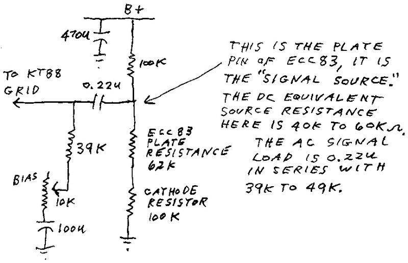

I'm sorry but I'm not sure what you mean here. The pots are used to balance each half of the push-pull stage.
That's because they present a varying load to the previous stage.
Here is the equivalent circuit (below) of the interstage coupling from the phase inverter to the final stage. As you can see, the source impedance at the ECC83 plate is somewhere around 40K to 60KΩ. This could be represented as a voltage source in series with 50KΩ. As you load this high impedance voltage source with the Bias network of 39K to 49K, its voltage (the plate voltage) will obviously drop (only for AC due to the coupling cap.)
With the Bias pot at 10K, the signal voltage at the KT88 grid will be 49% of the ECC83 plate signal.
With the Bias pot at 0Ω, the signal voltage at the KT88 grid will be 44% of the ECC83 plate signal.
That's why I suggested bypassing the individual wipers of the Bias pots, to keep the AC signal impedance constant when changing the Bias settings.
Since the real-world hardware doesn't always exactly match the schematic, I probably should have said to bypass the junction of the 39K resistors and the pots.
(Isn't analog design fun? It seems there is always SOMETHING!)
I actually don't think it's this bad. The output impedance of the cathodyne stage is ##2/g_{m}## for ac signals. The transconductance of the ECC83 is listed as ##g_{m}=1.6\text{mA/V}##, so the output resistance is only about ##1250\Omega##. Even with the pot at zero, this still allows about 97% of the signal to get to the grid of the KT88. The low output resistance of the cathodyne is actually one of the main reasons I chose to use it for the phase splitter stage.
You could well be correct. The only way to tell for sure is remove the KT66s, put a signal on the input and the 'scope on the KT66 grid. Then watch the scope trace while adjusting the Bias pot. Also check if there is any interaction from one pot to the other output, i.e. does turning one pot change the output at the other grid. Supposedly, the Plate output is more sensitive to load unbalance than the Cathode output. (ref. http://www.valvewizard.co.uk/cathodyne.pdf)
Hope you can do this, I too would like to learn more about that phase splitter.
Okay, I will look into this. When I was initially adjusting the pots, I did stick the oscilloscope on the outputs and it looked okay but I did not take specific measurements.
