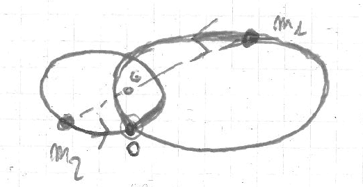

Let's go step by step. The provided Lagrangian describes a binary system (rough sketch below):
Where ##G## denotes the center of mass of the two body problem (in astronomy it is called barycenter if I am not mistaken) and ##O## the origin of cartesian coordinates.

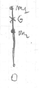

Let's analyse when both masses are aligned with ##G## (rough sketch below):
We can use the definition of center of mass to get:
$$\mathbf R(m_1 + m_2) = m_1 \mathbf r_1 + m_2 \mathbf r_2 \ \ \ \ (1)$$

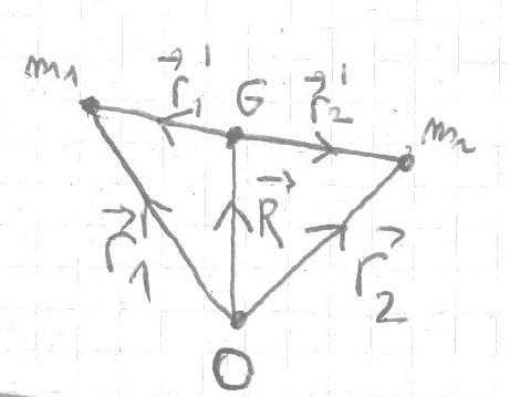

Now let's analyse when both masses are not aligned with ##G## (rough sketch below):
Based on the diagram we can get two more equations for ##\mathbf r_1## and ##\mathbf r_2##
$$\mathbf r_1 = \mathbf R + \mathbf r_1' \ \ \ \ (2)$$
$$\mathbf r_2 = \mathbf R + \mathbf r_2' \ \ \ \ (3)$$
We now can get equations for ##\mathbf r_1'## and ##\mathbf r_2'## in function of ##\mathbf r## only by applying some algebra: solve equation ##(1)## for ##\mathbf R## and plug it into ##\mathbf r_1' = \mathbf r_1 - \mathbf R## to get
$$\mathbf r_1' = \frac{m_2 \mathbf r}{m_1 + m_2} \ \ \ \ (4)$$
Now plugging the solved-for-##\mathbf R## equation ##(1)## into ##\mathbf r_2' = \mathbf r_2 - \mathbf R## we get
$$\mathbf r_2' = -\frac{m_1 \mathbf r}{m_1 + m_2} \ \ \ \ (5)$$
Where I have used the definition
$$\mathbf r := \mathbf r_1 - \mathbf r_2 = \mathbf r_1' - \mathbf r_2' \ \ \ \ (6)$$
OK so far! :)
Now we note that the given Lagrangian is a function of ##\mathbf r_1##, ##\mathbf r_2##, ##\mathbf {\dot r_1}## and ##\mathbf {\dot r_2}## (AKA ##L(\mathbf r_1, \mathbf r_2, \mathbf {\dot r_1}, \mathbf {\dot r_2})##). After googling a bit I found that I should go for a Lagrangian ##L(\mathbf R, \mathbf r)## (see for instance the attached file, beginning of page 8).To do so we need to apply the following equations into the given Lagrangian (which is ##L = \frac 1 2 m_1 \mathbf {|\dot r_1|^2} + \frac 1 2 m_1 \mathbf {|\dot r_2|^2} + G \frac{m_1 m_2}{|\mathbf r_1 - \mathbf r_2|}##):
$$\mathbf r = \mathbf r_1 - \mathbf r_2$$
$$\mathbf r_1 = \mathbf R + \mathbf r_1$$
$$\mathbf r_2 = \mathbf R + \mathbf r_2$$
Noticing that
$$\mathbf {|\dot r_1|^2} = \mathbf {|\dot R|^2} + \frac{m_2^2}{(m_1 + m_2)^2} \mathbf {|\dot r|^2} \ \ \ \ (7)$$
$$\mathbf {|\dot r_2|^2} = \mathbf {|\dot R|^2} + \frac{m_1^2}{(m_1 + m_2)^2} \mathbf {|\dot r|^2} \ \ \ \ (8)$$
Thus we get
$$L = \frac 1 2 \Big( m_1 \mathbf {|\dot R|^2} + \frac{m_1 m_2^2}{(m_1 + m_2)^2} \mathbf {|\dot r|^2} + m_2 \mathbf {|\dot R|^2} + \frac{m_2 m_1^2}{(m_1 + m_2)^2} \mathbf {|\dot r|^2} \Big) + G \frac{m_1 m_2} {|\mathbf r|}$$
Simplifying we get
$$L = \frac 1 2 ( m_1 + m_2 ) \mathbf {|\dot R|^2} + \frac{m_1 m_2}{2(m_1 + m_2)} \mathbf {|\dot r|^2} + G \frac{m_1 m_2} {|\mathbf r|}\ \ \ \ (9)$$
