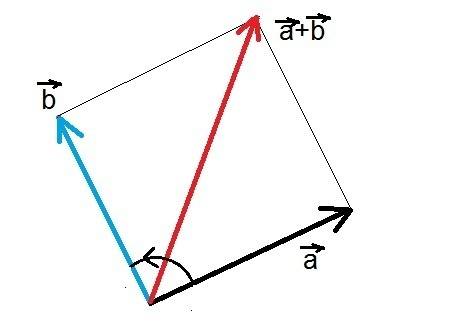

@LCKurtz ingenious suggestion was to find a vector that is of equal length and perpendicular to the original one, and then add the two vectors. The resultant vector halves the angle between ##\vec a## and ##\vec b##. See figure.
You get the blue vector if rotating ##\vec a = 7\vec i + 6 \vec j ## by 90°. ##\vec b = -6\vec i + 7 \vec j##. Adding them: ##\vec a + \vec b = 1\vec i + 13 \vec j##. Now you have to divide it by the norm. Do the same with the other perpendicular vector, negative of ##\vec b ##.

Ohhhh, thank you for that picture. I understand now. I knew that the 45 degree vector would be half the 90 degree, but I wasn't too sure on how to get it there. Thank you for the picture.
