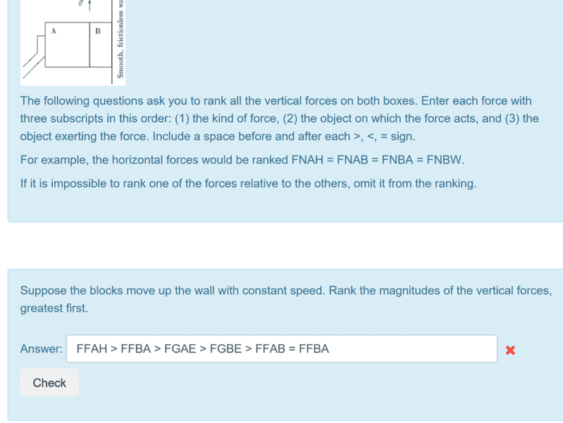

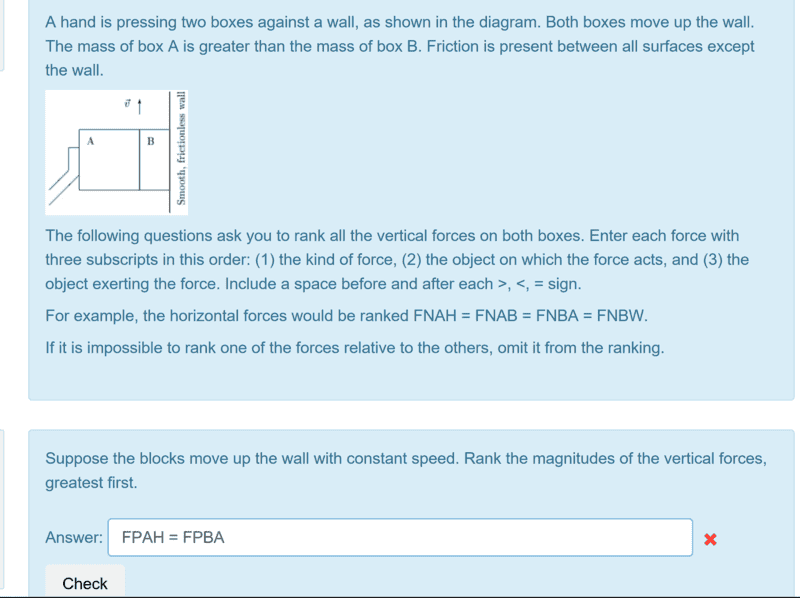

hey i figured that problem out, do you understand ranking forces?
ahh i see one thing i did wrong here...
i never read the problems carefully because i am an idiot, i could have gotten a B on my calc 2 exam but i got a C because i was looking for volume rather than surface area, i didn't realize until i only had 20 minutes left for the exam and i ended up with a C
But this ranking forces stuff is still very confusing
Vertical forces, Force on block A from hand > force on block b from block A > force gravity on block A from Earth > force gravity on block b from Earth > force friction between both blocks that are equal
Incorrect
Incorrect
That last attempt is clearly wrong since you have FFBA > ... FFBA.
It might help if you start by writing out the usual force balance equations for each block.
