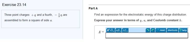

Find an expression for the electrostatic energy of this charge distribution.

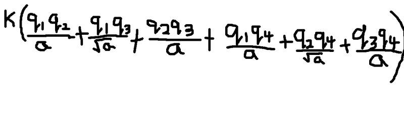

work = kqqq/(distance)
http://i33.photobucket.com/albums/d86/warnexus/electrodiag.jpg
Check the distance you've used for the diagonals. Substitute 'q' and 'q/2' for the appropriate charges and simplify.
the distance I used for the diagonals is sqrt of a. I do not understand I do not have q/2.
Is the length of a diagonal of a square of side length a equal to √a ?
You have two sizes of charge: One is 'q', the other is 'q/2'. Make the appropriate symbolic substitutions.
oops the diagonal is suppose to be sqrt 2a^2.
heres the substitutions:
k(qq/a + qq/sqrt(2a^2) + qq/a -1/2qq/a -1/2qq/a -1/2qq/sqrt(2a^2))
Okay, but you can simplify further. For example, you can pull out the q2 from each term.
heres the simplification
kqq(1/a + 1/sqrt(2a^2) + 1/a - (1/a) - (1/2)/sqrt (2a^2)
You can collect the terms, putting them over a common denominator...
