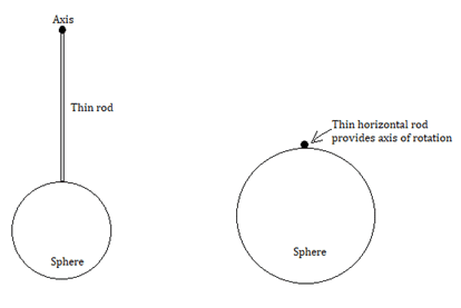

A solid sphere of mass M and radius R is suspended from a thin rod. The sphere can swing back and forth at the bottom of the rod. Find an expression for the frequency of small angle oscillations.
f = 1/2(pi) sqrt(MgR/I)
I for a solid sphere 2/5MR^2
[/B]
I simply plugged the moment of inertia into the equation for the frequency and that yielded:
1/2(pi) sqrt(5g/2R)
but the answer is:
1/2(pi) sqrt(5g/7R)
Does anyone know what my missing is?
Review the meaning of R and I in the equation f = 1/2(pi) sqrt(MgR/I). R is not the radius of the sphere and I is not the moment of inertia of the sphere about an axis through the center of the sphere.
Generically, R = l which is the distance from the pivot point to the center of mass. I thought the moment of inertia would be that of a sphere about an axis through the center. ..am I just not visualizing this correctly?
Is the setup like either of the pictures below?
Yes
No, check out this page and pay particular attention to the meaning of ##I_{\rm support}##.
http://hyperphysics.phy-astr.gsu.edu/hbase/pendp.html
