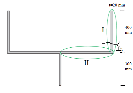

Find an expression for the shear stress of this figure

Summary: I have trouble to define the y distance in my coordinatesystem
I need to find an expression for the shear stress on the I figure, where the green parabola illustrates the function. I made a cut, where I defined the length from the start of figure I to the cut as z1. The formula for calculating the shear stress:
τ=V*Q/I*t
V=183 kN (Shear)
Q=A*y
I=804.95*10^6 mm^4 (inertiamoment)
t=20 mm (thickness)
Ignore the II figure. My problem is on Q=A*y
The area A of the figure on my analyze is:
A=t*(400-z1)
The y distance confuses me and from the assignment, the center of the gravity is `y=368.44 mm. So my thought is that the distance from the center of the figure I and the `y=368.44 mm is expressed:
y=(400mm/2 - z1 - 368.44 mm)
So my function of shear stress is:
τ=183*10^3N* (t*(400-z1)) * (400mm/2 - z1 - 368.44 mm) / I * t
I think my y distance is wrong so would appreciate if someone could explain me how it is suppose to be.
I’m not sure of your signage, but the math error is that you forgot to divide z1 by 2 in your expression for y. Also the parabolic green curve is not correctly shown.
