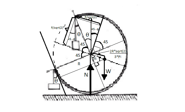

Find the angle Theta so that the system is in equilibrium
Mass of each block: 2 Kg
Mass of ring: 4π Kg
Static equilibrium:
Rotational equilibrium
Static equilibrium:
2g + 2g + 4πg = Normal
N = 4g + 4πg
Taking the torque with respect to the center of mass:
(N*(cosθ + sinθ)*2R*√2)/√2 * 3π + g*R(cosθ-sinθ) = [ 2*g*(cosθ+sinθ)*( (R/√2) + (2R√2)/3π) ] / √2 + 2*g*cosθ *(R + 2R/3π) + 2g*sinθ*(2R/3π)
This doesn't lead me anywhere.
Thanks for your help
Dag Anton, :welcome:
Center of mass is way too complicated: depends on ##\theta##. Take the support point or the center of the circle
Not sure whether you figured this out, but I believe the given mass 4π is for the complete ring, so the 3/4 ring shown has mass 3π.
It will be easier to think about if you add in the missing quarter ring, plus another placed symmetrically on the other side to compensate. Then you only have to deal with that quarter ring balancing the two suspended masses.
What are the x and y coordinates of the mass centre of the quarter ring, relative to the circle's centre?
