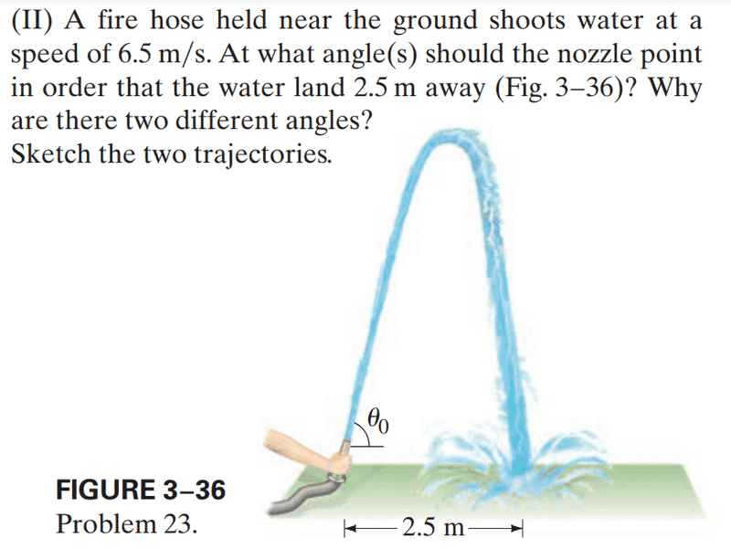

A fire hose held near the ground shoots water at a
speed of 6.5 m / s. At what angle(s) should the nozzle point
in order that the water land 2.5 m away?
X = V0 * t + 1/2at^2. t = 2V0y / 9.8
We know the time it takes the water complete the whole parabola is (sin(x) * 6.5 * 2) / 9.8.
So I come up with (sin(x) * 6.5 * 2) / 9.8 * cos(x) * 6.5 = 2.5, because the x component of the velocity is the same for the whole time.
But I get the results like these: x≈0.30929171+πn,1.26150461+πn.
I see the correct results are x=72.27889027+180n,17.72110972+180nx
When I use t = 2.5 / cos(x) * 6.5 and plug it in 0 = sin(x) * 6.5 * (2.5 / cos(x) * 6.5) - 4.9 * (2.5 / cos(x) * 6.5) ^ 2, I get the desired results.
I don't know what is not right in (sin(x) * 6.5 * 2) / 9.8 * cos(x) * 6.5 = 2.5 that gets me wrong.

For starters: don't use the symbol ##x## for angle AND for distance. It will cost you dearly sooner or later.
(especially if the exercise text already has a symbol ##\theta_0## for the angle !)
In your relevant equations you have a ##V_0##. What is it ? Aha, after a long :wink: study, I deduce that the second one is Not ##V_0\,y## but ##V_{0,y}##, a.k.a. ##V_0\sin\theta_0##. Did I conclude correctly ?
And you know ##t = 2\, V_0\sin\theta_0 /g## is the time, which can be inserted in ##x = V_{0,x} \, t ##. Where ##V_{0,x} = V_0 \cos\theta_0##.
One equation with one unknown.
Your results make no sense to me. Way too many digits and you want to restrict them to ##0<\theta_0<{\pi\over 2}##
Re
Well, it can't be right, because the dimensions left and right are different !
[edit ] Oops, I think goofed here (imagined brackets :nb))
[edit2]Actually, the expression is quite correct and indeed, ## 2\, V_0\sin\theta_0 /g \,V_0 \cos\theta_0 ## is really 2.5 m.
So it must be going off the rails somewhere in your path to solve that for ##\theta_0##.
What are your steps ?
[edit3]Ah, I see. What a mess. All because of chaotic symbol use!
You have ##y = V_{0,y} t + {1\over 2} gt^2## and solve for ##y=0##, from which ##t = 2V_{0,y}/g##.
For ##x## you have ##x=V_{0,x}t = V_{0,x}\,2V_{0,y}/g = 2V_0^2/g \cos\theta_0\sin\theta_0##.
Solving for ##\theta_0##: ##\sin(2\theta_0) = xg/V_0^2 \Rightarrow 2\theta_0 = 0.618 \ \text {or} \ 2\theta_0 = \pi - 0.618##.
The former gives your ##\theta_0 = 0.309## which is correct (!) and the latter yields your ##\theta_0 = 1.26 ## which is also correct.
In short: well done and on to the next exercise :smile: !

DrClaude said:
The first above is in radians while the lower is in degrees.
Thank you for helping me out! I was telling my calculator to give results in degrees, but it keeps displaying those numbers ;)
