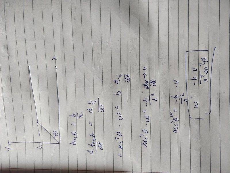

A particle is moving parallel to x-axis in the positive direction with velocity v such that at all the instants the y -axis component of its position vector is constant and is equal to 'b'. Find angular velocity about origin.
I thought that angular velocity would be the rate of change of the angle of the position vector of the particle with the origin, let's say theta. So I wrote tan (theta) = b/x and differentiated with time but got the wrong answer.

Thats what I am getting, but the answer is different in the book, I checked the solutions and what they had done is that they took component of velocity perpendicular to position vector and then differentiated, I have a feeling that its wrong because that's not what my teacher taught, what do you think?

I think the two approaches should give same result. Can you give us what is the final answer from your book?
Its [v sin^2(theta)]/b
are you quite sure that is different? Note that you were not given x, so you should eliminate that from your answer.
It is the same as we calculated, it is easy to see that ##\sin^2(\theta(t))=\frac{b^2}{b^2+x(t)^2}##
Ohh I didn't see that, thank you! But how do I justify the book's approach, I don't understand why their answer is correct. They have divided the magnitude of component of velocity perpendicular to position vector by the magnitude of position vector.
If you resolve the motion vector into radial and tangential components relative to the origin then only the tangential component causes the angle to change. vtangential=rradialω.
