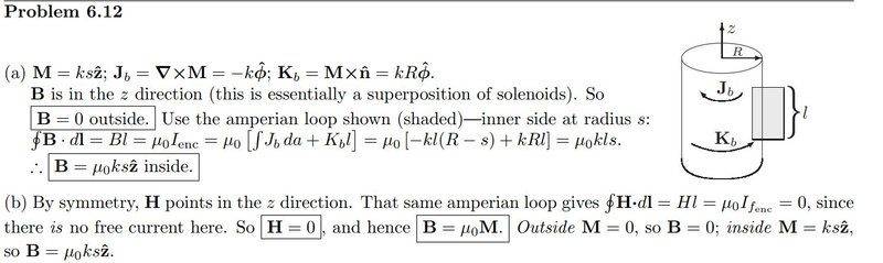

An infinitely long cylinder of radius a has its axis along the z-direction. It has Magnetization ##M=M_0(s/a)^2\hat{\phi}## in cylindrical coordinates where ##M_0## is a constant and s is the perpendicular distance from the axis. Find the values of ##\vec{B}## and ##\vec{H}## everywhere.
##\vec{k_b} = \vec{M}\times \hat{n}##
##\vec{J_b}=\vec{\nabla}\times \vec{M}##
##\vec{H} = \frac{1}{\mu_0}\vec{B}-\vec{M}##
[/B]
##\vec{k_b}## and ##\vec{J_b}## are straightforward to calculate so I will just list the results.
$$ \vec{k_b}|_{r=a}=-M_0 \\ \vec{J_b}=\frac{3M_0s}{a^2}$$
I'm pretty sure these are correct since summing up the total bound charge gives 0:
$$Q=\int_0^a J_b\cdot da + k_b * (2\pi a) = \frac{6\pi M_0}{a^2}\int_0^a s^2ds -2\pi aM_0 = 2\pi M_0a-2\pi M_0a=0$$
Since there's no free charge in the problem ##\vec{H}=0## everywhere. Then for ##r < a## we have $$B=\mu_0\vec{M}=\mu_0M_0\frac{s^2}{a^2}\hat{\phi}$$
However, if I try to calculate this using Ampere's law with an amperian loop similar to those used for a solenoid I find: (a-s)L area of cylinder inside amperian loop for r < a)
$$ B(s)\cdot L = \mu_0 I_{encl} = \mu_0(\vec{J_b}\cdot(a-s)L +\vec{k_b}L)=\mu_0M_0L\left(\frac{3s(a-s)}{a^2}-1\right)$$
and this obviously isn't going to give the same result as I found using ##\vec{H}##. I'm not sure where I'm going wrong as this is very similar to problem 6.12 in griffiths electrodynamics 4th edition and I'm basically employing all of the same techniques.

Ok, the difference was in the book that their ##\vec{J_b}## was a constant so they could just multiply by the area to get the result of the integral however, my ##\vec{J_b}## is linear w.r.t. s although I am still running into trouble.
Defining ##dA =l \,ds\Longrightarrow \int_s^a J_d\cdot dA =\frac{3M_0l}{a^2}\int_s^a s\,ds## results in ##\int J_d\cdot dA = \frac{3M_0l}{2}(1-(s/a)^2)##. I'm clearly still missing something as the 3/2 coefficient is a problem.
You have the geometry all confused. This is not a solenoid type problem. You have current (## \vec{J}_m ##) going along a wire in the +z direction. Computing ## B ## for that is fairly simple with Ampere's law= You need a circular loop for your Ampere's law path. I think with that hint, you might also now find it very easy.
Likes Potatochip911

Yes I agree that geometry doesn't make much sense to me either I was just copying what they had done. Setting up the problem as $$\vec{B}(2\pi s) = \mu_0(\int_s^a J_d\cdot 2\pi s\, ds - M_0\cdot 2\pi a) $$ results in the answer of $$\vec{B} = -\mu_0 M_0 (s/a)^2\hat{\phi}$$ which is just the negative of what I was finding before.
I'm attaching how they solved a similar problem in the solutions manual since they are using the flat ampere loop for a cylinder and getting the correct result for their problem. Perhaps you can explain how it's working?
The left side is correct. For the right side, the limits should be ## 0 ## to ## s ##, the ## dA=2 \pi s \, ds ##, and any current outside of the circular loop of radius ## s ## isn't counted. This is a simple Ampere's law calculation for the current that travels through the loop which is the circle of the ## \oint \vec{B} \cdot \, dl ## integral.
Likes Potatochip911
@Potatochip911 In the attachment of your previous post, the magnetization ## \vec{M} ## is in the +z direction. For that case, the surface currents have the same geometry as the currents of a solenoid. ## \\ ## The problem you are working here has magnetization ## \vec{M} ## in the ## \phi ## direction.
Likes Potatochip911
