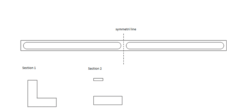

Hi, I'm trying to figure out how to calculate the stresses in my beam. The cross section varies (shown in the picture), and I don't know how I'm supposed to think to find the maximum stress. I appreciate tips or links to learn how to do it. Thanks. Sorry if the picture is bad, but I hope you understand what I mean.
I don't know what to do when my cross section varies.
There are standard methods for dealing with variable section beams . Have you done any research online or looked in any standard reference books such as Timoshenko or Megson ?
What are the full details of the actual problem that you are dealing with ?

Hi, the problem is to design a beam by myself. I don't have any spesific dimensions. The problem is that I don't know how to deal with it when it goes from one cross section to another. I have tried to look it up on online, but didn't find anything. I just know that it should look something like that with a hole for a wheel to roll into.
Thanks! :)

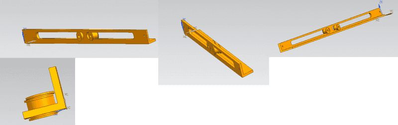

Try posting a 3D sketch of the whole assembly of beam , wheels and any other related components .

Something like this. The forces come from the wheel because they are supporting a weight.
