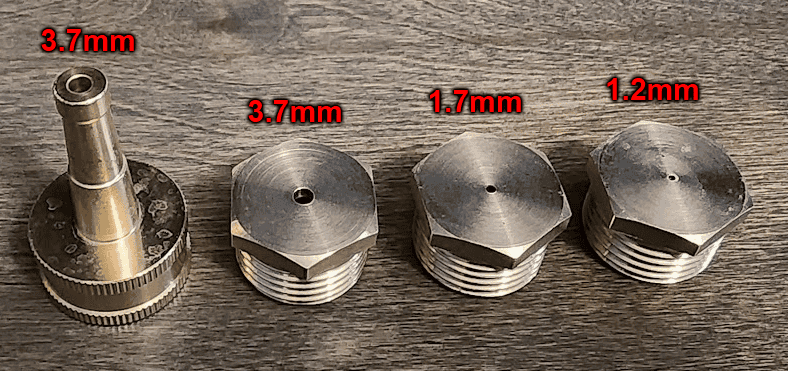

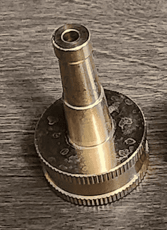

I tried a bunch of different "jet" style nozzles, and this one seemed to perform the best as far as distance is concerned. The hole is 3.7mm in diameter:
As a test, I drilled the same 3.7mm hole in a brass garden hose plug, and it performed pretty much exactly the same (to my surprise):
Initial testing using the above nozzles. I have a pressure gauge right before the nozzle:
Garden hose reads 50psi when closed at the nozzle. When fully open, pressure reads 0 psi and water shoots about 20 feet.
Using 1 pump, pressure reads 115psi when closed at the nozzle. When fully open, pressure reads 30-40psi, and water shoots about 65 feet.
Using 2 pumps in series, pressure reads 150psi when closed at the nozzle. When fully open, pressure reads about 100psi, and water shoots about 90 feet.
There is a decent amount of misting/spraying surrounding the stream - it sort of resembles those large sprinklers at parks and golf courses.
I decided to do some more testing with different diameter holes, just on the garden hose with no pump:
I mentioned above, the 3.7mm hole yielded a distance of about 20 feet. To my surprise, the 1.7mm hole performed the best, and gave a fairly steady stream (not much mist) and got 30 feet. Pressure guage read 20 psi right before the nozzle. I tried this same 1.7mm nozzle with a single pump, and the distance actually went down slightly to 25 feet, with a lot more water spray and mist. The pressure guage read 60psi. It looks like a lot more water volume is flowing out of the nozzle, but its less controlled.
The 1.2mm got about 25 feet with the garden hose (lots of spray/mist), and about 20 feet with the single pump (a lot more spray/mist). Pressure gauge read 80psi.

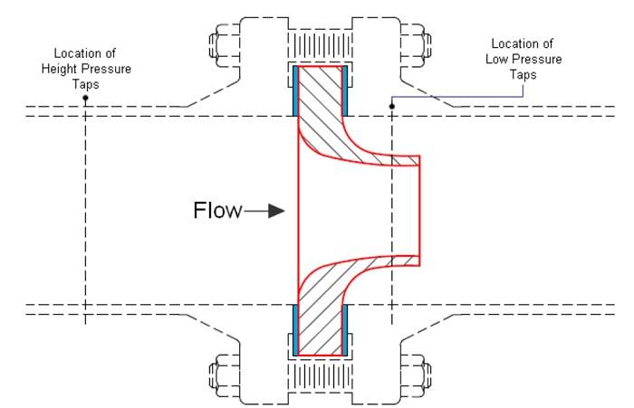

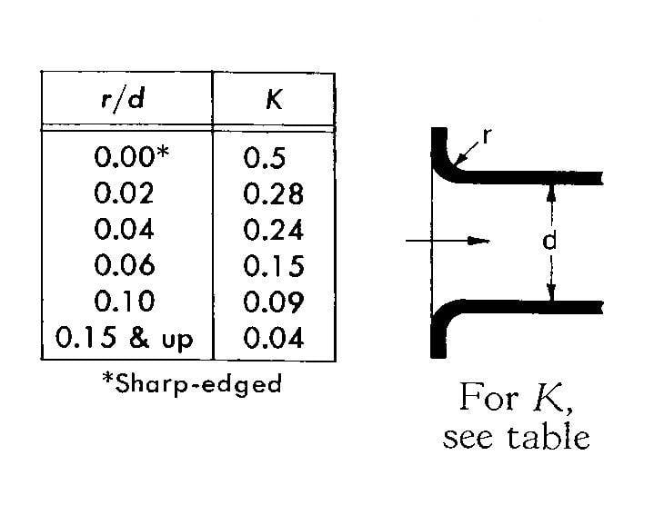

A nozzle is more than just a hole drilled in a piece of metal. It is also the entrance to that hole. A square edge entrance, or worse yet a burr at the entrance, reduces the flow while adding turbulence. The effect of entrance edge shape on flow coefficient K is shown in this figure from Crane Technical Paper No. 410:
The sharp edge case, r/d equals 0, is the case of a hole drilled without burrs. A square edge causes a vena contracta (search the term). The vena contracta not only reduces the flow, but causes turbulence. That turbulence is probably the cause of the spray and mist. The entrance radius is made large in pipe flow nozzles (search the term), which are used in pipe flow measurements. A typical flow nozzle (screen grab from https://www.wermac.org/specials/flownozzle.html) is shown below:
I expect that rounding the entrance to your drilled holes will deliver less spray and mist along with greater distance. If you still get spray and mist, I suggest connecting the garden hose to a 5 to 10 foot length of straight pipe. The length of straight pipe reduce flow turbulence entering the nozzle. Then experiment with hole diameters.

Thanks a lot for this information, very helpful!
I can easily countersink the back of the hole at an angle, such as 45 degrees. Rounding it as in putting a radius on it will be a little trickly. I'll see what I can come up with here.
I will also try a length of straight pipe (same inner diameter as the hose I am assuming?). What about the length of the nozzle? E.g. the length after the radius. Is there any benefit to adding length to that 1.7mm hole?

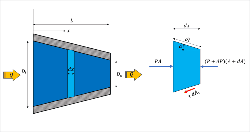

To me it seems like there is going to be an optimum nozzle length that maximizes the outlet velocity based on the remaining system/pump curve characteristics.
I'm imagining a linearly converging nozzle (truncated cone):
Aplying Newton Second to the differential element:
$$ -\frac{dP}{dx}A - P\frac{dA}{dx} - \tau (x)\frac{dA_s}{dx} \cos \alpha = \rho A v \frac{dv}{dx} $$
With
##A(x)v(x) = Q = \text{const.}## incompressible flow
## D(x) = D_i - \frac{D_i - D_o}{L}x ##
## A(x) = \frac{\pi}{4}{D(x)}^2 ##
## \frac{dA}{dx} = -\frac{\pi}{2} \frac{D_i - D_o}{L} D(x) ##
## \frac{dA_s}{dx} \cos \alpha = \pi D(x)##
## \frac{dv}{dx} = Q \frac{ \frac{\pi}{2} \frac{D_i - D_o}{L} }{{A(x)}^2}D(x) ##A first order ODE with non-constant coefficients. I haven't taken that part any further yet, but the idea is to describe the pressure gradient as a function of ##Q## using that result and sweep the other parameters ##D_o, L## in concert with post #2 for the rest of the system to find the maximum discharge velocity.
Keeping the flow non turbulent at the exit pigeonholes the velocity for a certain outlet diameter via the Reynolds Number, and I'm not sure if that is good if the sole objective is just to get water to land as far away as possible?

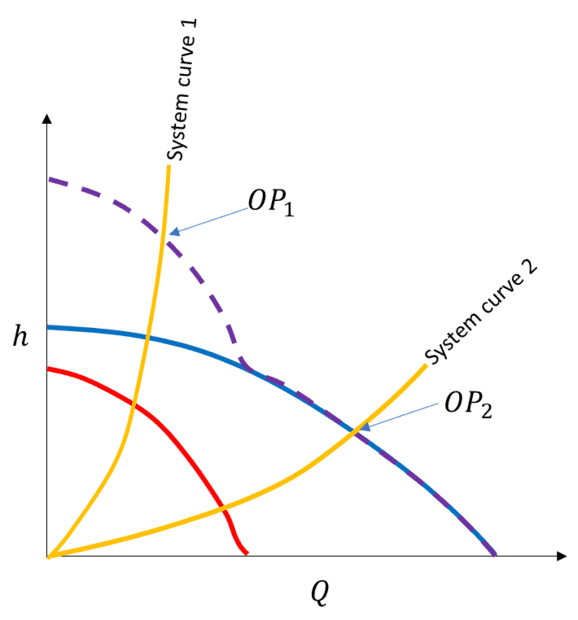

erobz said:
With pumps in series you add the head from each pump at a given volumetric flowrate to get the effective pump curve.
Is that necessarily true? I would have thought that they would need to be coupled with a suitable 'chamber' to iron out pressure and flow variations between output one and input two or they would 'see each other'. as the saying goes. It could be analogous to connecting two alternators in series and expecting to get twice the AC volts.
But what do I know? It may be that it's never an issue in practice.
I could see some issues with very different pumps in certain systems, but I can't see any issues that a check valve wouldn't take care of other than perhaps one or both of the pumps running at a point of low flow or low efficiency and perhaps heating up. Obviously the absolute pressure in the system should not exceed the rating of the pump ( we don't want to split the casing, ect...), so adding in series has limits there. Is this what you are thinking can go wrong or did you have something else in mind?
Likes sophiecentaur
For instance, the red and blue curves are different pumps. When added in series they form the composite purple dashed curve. You aren't going to be running both in system 2 as the red pump just becomes a load on the blue pump, while consuming power on its own for nothing.
So in practice the engineer would not specify this series combination for system 2.
There is probably a no-fly zone a dozen other ways, but in general for a system of pumps in series adding the heads at a given flow is the model for the composite pump curve. That is what I was saying, not that anything can (should) be done without consideration of the final result.
I need a bit of help here, please because something seems to be missing to get from this to the height / distance reached by the jet. The exit v needs to be enough for the wanted trajectory but the graphs appear to correspond to filling a reservoir at the level of the top of the hose. Is there enough information to infer the exit velocity of the actual nozzle
I assume the H value is the height achieved with a particular hose. It implies that the max value of pressure at the nozzle will be zero so the velocity of the water will be zero. To get a jet to go higher than this then you need to have the nozzle below H max and the flow rate needs to be enough so that the exit velocity (end of the taper) . The pressure at the start of the taper needs to be enough to give the required exit v whilst keeping the volume flow constant. You're operating further out from the y axis, on an increasingly negative slope/
Do you see my problem? It may only need a few words to reassure me it's all OK.
It's just a case of mistaken identity. ##h## is the “head”, (pressure per unit specific weight of the fluid being pumped through the system). That graph was directed to your last response about the effect of different pumps "seeing each other", not about the solution.
Yes. I get that but the graphs show the performance of two individual pumps and then the combination performance. The OP's data gives H and Q. For each pump, the head is maximum when Q is zero (no?). You will only get flow when operating below that. To get a high enough velocity on exit, you have to operate at below the h max.
But. in any case, that diagram (and the spec of the OPs pump) seems to deal with filling a tank at h. Imparting some 'extra velocity' is another matter, surely. You need Power at the nozzle to accelerate the water as it goes into the narrowing section. Using the nozzle at a lower level can make this power available and will allow a jet to go higher / further but isn't there a limit? How much better than static head can one do?
Operating the nozzle at ground level requires a suitable v to take the trajectory to the required "100ft" theoretically but the jet has to have a certain minimum diameter to keep it intact and laminar. Doesn't that impose a definite maximum range for any given pump characteristic (power and 'effective internal and very non-linear resistance')? Electrical analogy makes the problem more familiar to me.

I don't see that data, I see a single point on the pump curve.
HAHA I see a red line and a blue line. Are they not the pump characteristics?
erobz said:
None, but that corresponds to no flow ( zero outlet velocity) in the system and consequently zero range. To impart kinetic energy the real pump has to very inefficiently trade potential energy for kinetic energy.
But hang on. What you say is true for a uniform hose diameter. If that was the only height you could get then why have a tapered nozzle at all? Once the water has emerged from the hose, its trajectory will depend on the actual velocity and not the volume flow rate. The velocity is also a function of the pipe (nozzle) diameter and the KE is proportional to the velocity squared.
No, I just conjured them out of thin air to illustrate adding pumps (curves) in series to show where a problem may occur if the system had the characteristics of "system 2".
The outlet velocity depends on the flowrate corresponding to the steady state operating point. That is the intersection of what the pump can supply (pressure) as a function of flowrate, and what the system demands at that same flowrate. If you change the nozzle you change the operating point. When you say static head, I assume you mean pump static head, because there is virtually no system static head here. That equates to the no flow condition of the pump. That is the maximum height of a column of water which a particular pump could support. You can't do better than that at any flowrate as far as flow kinetic energy is concerned.
