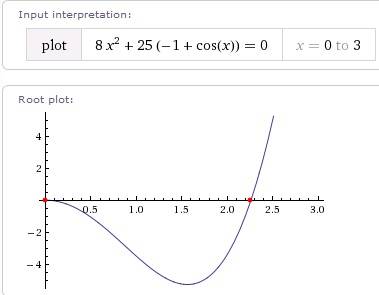

I would have looked at a graph of the function:
From this we see the root we seek is about $$x\approx2.25$$.
