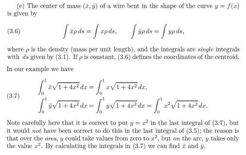

A uniform chain hangs in the shape of the catenary y=cosh(x) between x=−1 and x=1
Find [itex]\bar{y}[/itex]
∫[itex]\bar{y}[/itex][itex]\rho[/itex]ds=∫y[itex]\rho[/itex]ds
I can define ds (some small segment of the arc) by [itex]\sqrt{1+sinh(x)^2}[/itex]dx.
Also, y is given as y=cosh(x)
If I take the integral above from -1 to 1 as:
∫cosh(x)*[itex]\sqrt{1+sinh(x)^2}[/itex]dx
I get ~2.8
The problem I have with this answer is that the maximum y of this catenary is y=cosh(1) which is below y=2. The minimum value of the catenary is y=cosh(0)=1 so the y centroid should be somewhere between those two points.
What am I doing wrong? Thanks!
What does your ##\int ds## yield ?
Arc length. This turns out to be about 2.4 between x=-1 and x=1.
edit: from my book: (The example they use is y=x^2 between 0 and 1.)
Am I supposed to go about calculating the integral and then setting it equal to the form with [itex]\bar{y}[/itex] in it to solve for [itex]\bar{y}[/itex]?
Isn't that exactly what the last equation says?
You have to solve for y_COG from the equation as written in your notes.
Likes 1 person
If you factor the constant ##\bar y## out of the second equation of 3.6 and solve for ##\bar y## you will have the formula you need. You have just calculated part of it.
Correct. And the 2.8 you had before divided by the 2.4 arc length gives you ##\bar y## as per your own relevant equation in post #1. Done !
