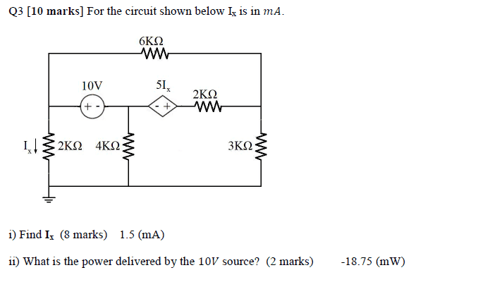

Find current using KVL (with dependent source)
In summary, the conversation is about solving a circuit problem using Kirchoff's Voltage Law. The equations used are V = IR and the values for the resistors in the circuit are given. The mistake was made in accounting for the given detail that Ix is in mA. After correcting the error, the proper equations are a(6000) + (a-b)(2000) + 5x - 10=0, -5x + (b-a)(2000) + b(3000) + (b-c)(4000) = 0, 10 + (c-b)(4000) + c(2000) = 0, and x/1000 = -c.

V = IR
[/B]
Top loop - a
Bottom right - b
Bottom left - c
Ix = x
KVL:
top: a(6000) + (a-b)(2000) + 5x - 10=0
bottom right: -5x + (b-a)(2000) + b(3000) + (b-c)(4000) = 0
bottom left : 10 + (c-b)(4000) + c(2000) = 0
x = -c
x comes out to 2 mA when it should be 1.5. Where did I make a mistake?
Thank you very much.
How did you account for the given detail that ##I_x## is in mA?
got it! That was the error. The proper equations were this:
x/1000 = -c
