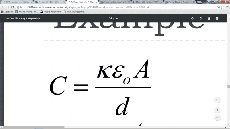

It's late at night so can someone please just tell me what the E0/E formula means and what formulae are relevant to the question? I asked around but the question is "sorcery" to everyone I know. Is the formula I attached below relevant? It is dependant on both capacitance and dialectric constant which makes it seem relevant but it invovles variables not given in the question (distance and area).
The formula attached is correct. It tells you that the capacitance will increase k times when you insert a dielectric of dielectric constant k. But final charge on the capacitor doesn't change after insertion of dielectric. Q=CV will be useful here.

How can the attached formula be used without knowing either k (dialectric constant) or A (area of the plate)? Also in an example the 3o is 8.85X10^-12, is this a constant?
romakarol said:
How can the attached formula be used without knowing either k (dialectric constant) or A (area of the palte)? Also in an example the 3o is 8.85X10^-12, is this a constant?
That formula can't be used directly. It only tells you that capacitance increases k times.
