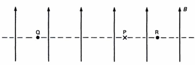

In summary, The diagram shows a uniform magnetic flux density B in the plane of the paper. The points Q and R mark the location of two long, straight, and parallel wires carrying the same current I in the same direction, perpendicular to the paper. The line through QR is perpendicular to the direction of B. Point P is a neutral point where the resultant magnetic flux density is zero and is closer to R than Q. (a) The direction of the current I can be determined by considering the direction of the resultant field from the two wires at point P. The net field must be in the opposite direction of the uniform field to cancel it out, so the current must be flowing out of the paper. (b) If the current I is
moenste
711
The diagram shows a uniform magnetic flux density B in the plane of the paper. Q and R mark the points where two long, straight and parallel wires carry the same current, I, in the same direction and perpendicular to the paper. The line through QR is at right angles to the direction of B.
P is a point where the resultant magnetic flux density is zero, i. e. it is a neutral point. P is closer to R than to Q.
(a) Explain whether the direction of the current I is into or out of the paper and sketch a diagram which shows the directions of the different magnetic flux densities present at P.
(b) If I is increased slightly, will the neutral point at P move towards Q or towards R?
(c) There is a second neutral point on the line through QR. State whether it is to the left of Q, between Q and R or to the right of R.

Ask yourself: Which wire, Q or R, creates the greater field at point P? Thus: Which direction is the net field from the wires at point P? And then: Does that oppose or add to the given uniform field?
Likes moenste
I would say wire R should have a greater field at point P.
What does it mean? How can we calculate the net field?
Exactly.
Since you know that wire R creates a greater field than wire Q, what does that tell you about the direction of the net field due to the two wires?
(Hint: At point P, do the fields from wires Q and R point in the same or opposite direction?)

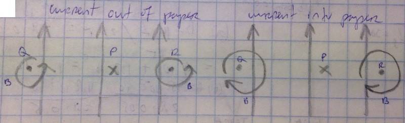

Out of paper: anti-clockwise (like R).
Into paper: clockwise (like R).
Like here:
Fproxy.php%3Fimage%3Dhttp%253A%252F%252Fs06.radikal.ru%252Fi179%252F1610%252Fe1%252F9697cce90dfd.jpg
Just answer my questions for point P. (It will be either "up" or "down" the page at that point.)
Likes moenste
If we are talking about the dimension of the image, then out of paper will be down and into paper will be up.
Good. And which is needed to get zero total field at P?
Likes moenste
Out of paper, because the field is already upwards?
Exactly. To cancel the upward uniform field, we need a downward field from the two wires.
