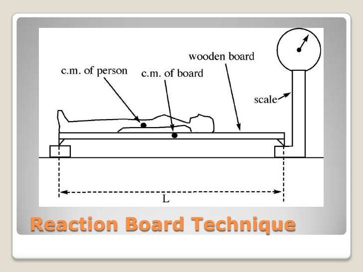

"A person’s center of mass is easily found by having the person lie on a reaction board. A horizontal 2.5-m-long, 6.1 kg reaction board is supported only at the ends, with one end resting on a scale and the other on a pivot. A 60 kg woman lies on the reaction board with her feet over the pivot. The scale reads 25 kg. What is the distance from the woman’s feet to her center of mass?"

You're flailing at this. The woman lies on a board which is supported at two ends. A scale is fitted at one end to record the support reaction there.
Knowing the mass of the board and its length, you know where the center of mass of the board is located from one end. You know the mass of the woman, but you don't know where her center of mass is located.
This is a simple problem in static equilibrium. You don't need angular momentum or the special theory of relativity to find the answer.
Draw a free body diagram of the reaction board first to help with your analysis.

Do you know what the equations of static equilibrium are?
You just need to balance the torque and you'll be good, SteamKing gives a good visualisation of how a reaction board works. Drawing the FBD youll only find one unknown force and balancing torque about that point will eliminate the need of that force. You can concentrate the mass of the woman at her COM and let it be at a distance x from that point. Solving the equation youll get x
