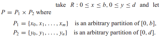

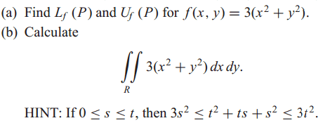

Find double integral over region R
In summary: The conversation is about finding the value of I in a double integral using the given hint and applying it to the given limits for x and y. The hint is that ##0\leq s \leq t##, and the given limits are ##0\leq x \leq b## and ##0\leq y \leq d##. The attempt at a solution involves expanding the terms and applying the hint to individual ranges of the partitions. However, there is also an alternative way to use the hint by invoking the intermediate value theorem. In the end, the final answer for I is found to be independent of the partitions, and thus it is equal to the supremum of the lower sums and the infimum of the
DryRun
838
For example, for f(x,y)=x+y-2
I've figured out part (a) which is quite simple. I simply used the relevant equations above for ##f(x,y)= 3(x^2+y^2)##
I know i should use the given hint to figure out the value of I, which is ##L_f(P)\leq I\leq U_f(P)##
But I'm not sure how to solve for the value of I, which I've calculated to be:

I think the point of the hint is that [itex]t^3 - s^3 = (t - s)(t^2 + st + s^2)[/itex].
Now
[tex]L_f(P) = \sum_i \sum_j 3(x_{i-1}^2 + y_{j-1}^2)(x_i - x_{i-1})(y_j - y_{j-1}) \\
\leq \sum_i \sum_j (x_{i-1}^2 + x_{i-1}x_i + x_i^2+ 3y_{j-1}^2)(x_i - x_{i-1})(y_j - y_{j-1}) \\
= \sum_i \sum_j (x_i^3 - x_{i-1}^3)(y_j - y_{j-1}) + \sum_i \sum_j 3y_{j-1}^2 (x_i - x_{i-1})(y_j - y_{j-1})
[/tex]
etc.
Similarly for [itex]U_f(P)[/itex], but the inequalities will be reversed.

The etc. here is that:
[tex]L_f(P) \leq \sum_i \sum_j (x_i^3 - x_{i-1}^3)(y_j - y_{j-1}) + \sum_i \sum_j 3y_{j-1}^2 (x_i - x_{i-1})(y_j - y_{j-1}) \\
\leq \sum_i \sum_j (x_i^3 - x_{i-1}^3)(y_j - y_{j-1}) + \sum_i \sum_j (x_i - x_{i-1})(y_j^3 - y_{j-1}^3) \\
= \sum_i (x_i^3 - x_{i-1}^3) \sum_j (y_j - y_{j-1}) + \sum_i (x_i - x_{i-1})\sum_j (y_j^3 - y_{j-1}^3) \\
= b^3d + d^3b[/tex]
by telescoping.
Hence [itex]L_f(P) \leq b^3d + d^3b[/itex]. But the right hand side is independent of [itex]P[/itex], so in fact [itex]\sup_P L_f(P) \leq b^3d + d^3b[/itex].
If you carry out the same calculation for [itex]U_f(P)[/itex], you should find that [itex]\inf_P U_f(P) \geq b^3d + d^3b[/itex].
So [itex]\sup_P L_f(P) \leq b^3d + d^3b \leq \inf_P U_f(P)[/itex] and if you invoke the proposition that a continuous function is integrable you are done:
[tex]\sup_P L_f(P) = b^3d + d^3b = \inf_P U_f(P)[/tex]

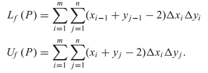

Here's an example from my notes:
http://img2.uploadhouse.com/fileuploads/17053/170536720903325240d5cea4d8f9181b2dd80f5a.png
From the last line, the middle terms in ##i## and ##j## appear to be the mid-points of ##x_i## and ##x_{i-1}##, and ##y_i## and ##y_{i-1}##.
This is the same method that I've applied to finding ##I##, related to the current problem ##f(x,y)= 3(x^2+y^2)##.
Yes: that works for [itex]f(x,y) = x + y - 2[/itex] because [itex](x_{i} + x_{i-1})(x_{i} - x_{i-1}) = x_{i}^2 - x_{i-1}^2[/itex], which gives a telescoping sum whose value is independent of the particular partition. In fact it's that line of thought (finding a telescoping sum) which leads one to consider [itex]x_i^3 - x_{i-1}^3 = (x_i^2 + x_ix_{i-1} + x_{i-1}^2)(x_i - x_{i-1})[/itex].

EDIT: I believe that i finally figured out what the hint really meant!
Given: ##0\leq s \leq t, 3s^2 \leq t^2 +ts +s^2 \leq 3t^2##
In this case, let ##s = x_{i-1}## and let ##t = x_i##, which makes sense in the inequality.
So, i get: ##0\leq x_{i-1} \leq x_i## which corresponds to:
$$3x^2_{i-1} \leq x^2_i +x_ix_{i-1} + x^2_{i-1} \leq 3x^2_i$$
Similarly, for ##0\leq y_{j-1} \leq y_j##:
$$3y^2_{i-1} \leq y^2_j +y_jy_{j-1} + y^2_{j-1} \leq 3y^2_j$$
Adding up those 2 inequalities:
$$3x^2_{i-1} + 3y^2_{j-1} \leq x^2_i +x_ix_{i-1} + x^2_{i-1} + y^2_j +y_jy_{j-1} + y^2_{j-1}\leq 3x^2_i + 3y^2_j$$
Now, if we go back to the original definition:
$$L_f(P)\leq I\leq U_f(P)
\\L_f(P) = \sum_{i=1}^m \sum_{j=1}^n 3(x_{i-1}^2 + y_{j-1}^2)(x_i - x_{i-1})(y_j - y_{j-1})
\\U_f(P) = \sum_{i=1}^m \sum_{j=1}^n 3(x_{i}^2 + y_{j}^2)(x_i - x_{i-1})(y_j - y_{j-1})$$
Therefore, the middle term of the inequality becomes:$$I = \sum_{i=1}^m \sum_{j=1}^n (x^2_i +x_ix_{i-1} + x^2_{i-1} + y^2_j +y_jy_{j-1} + y^2_{j-1})(x_i - x_{i-1})(y_j - y_{j-1})$$
Then, simplifying gives:
$$\sum_i \sum_j (x_i^3 - x_{i-1}^3)(y_j - y_{j-1}) + \sum_i \sum_j (x_i - x_{i-1})(y_j^3 - y_{j-1}^3) \\
= b^3d + d^3b$$
This is a much simpler method!
